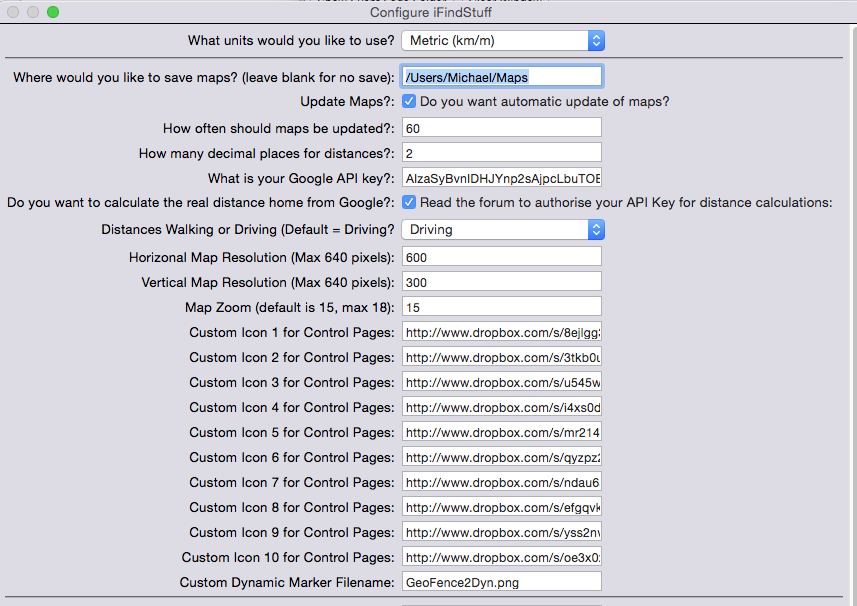

Maps are stored locally on your server machine. This applies to both the Static and Dynamic maps (more about that later). You decide where to put the maps on the Plugins/iFindStuff/Configuration menu option. It's important that you know the location and have write access to the folder. On my system I created a folder called /Users/Michael/Maps. This location is used to save ALL maps and also as a repository for image icon files that you should have downloaded from the server when you updated iFindStuff.
How often should they be updated?
While you're on the Config screen you can also set a couple of other options. To generate any Maps you must select the checkbox Update Maps? You also need to provide a frequency in seconds. I use 60 seconds but you can make it more or less. Actually, there probably isn't much point making it shorter than half your update frequency for devices.

There are a few other map options on the Config screen. The defaults that are there should be ok for most people but you can change them.
  • Horizontal - number of pixels resolution for a Static Map (maximum is 640) - I use 600
    Vertical - number of pixels resolution for a Static Map (maximum is 640) - I use 300
    Zoom - Zoom Level 0-21 where 0=Whole World on a Map to 21 - one House on a map... 15 is a good choice
You should also get a Google Maps API key and paste it on this dialog. This key allows you to have 25,000 map updates per 24 hours. Without it you're limited to 2,500 and these are shared between all Google Maps users with your broadband provider! The process for this is discussed on the forum. You need to get the key authorised for Distance Matrix as well if you're using the Real Distance features.

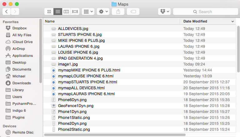

Static maps are generated by Google as a JPEG image file and that in turn is saved to the directory you selected in the first section. The file names are generated automatically from the Indigo Device Names. So in my case I have the following files in my /Users/Michael/Maps directory...
  • Saved map files...
    Saved map files...
    Screen Shot 2015-09-23 at 12.58.28.png (147.63 KiB) Viewed 4170 times
and a special file:
These are image files and will be updated automatically by iFindStuff according to the frequency you set on the Config screen. In my case every 60 seconds.
I use these files on Control pages (more on that later).
Dynamic maps are HTML files that are created by iFindStuff. They are saved as mymap[DEVICENAME].html files in the same Maps directory that you specified in the Maps menu. The advantage of Dynamic maps is that they are displayed on the Server Map in a browser window and behave exactly like Google Maps so you can Zoom in/out and Pan the screen. The disadvantage is that Indigo doesn't let you add these to control pages yet so they're not much good if your remote from your Mac.

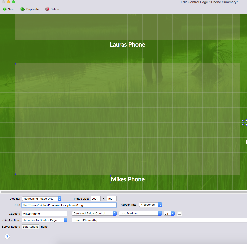

If you create a Control Page for Indigo you can add a Static Map file directly. If you add a New Control to a device page you can select Refreshing URL to Display in the first field and then specify the filename for the URL.
Control Page
Control Page
Screen Shot 2015-09-23 at 13.00.23.png (696.3 KiB) Viewed 4170 times
On a MAC it needs to be of the form:
file:///users/michael/maps/mikes iphone 6.jpg
Notice that it starts with file:// and then has the path to the Maps Directory /users/michael/maps/ (yes that is three '///'s) and then the filename mikes iphone6.jpg. You'll also notice that even though the file names are in CAPITALS in the folder I've used all lowercase.
Finally - I chose an Image Size that fits well on the page I'm creating. Often its 300 x 120 but the choice is up to you.

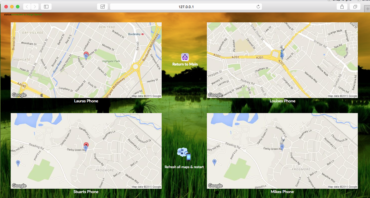

When the Control Page is viewed in a Browser or in Indigo Touch the placeholder will be replaced on the map. Here's an example with made up data :D
