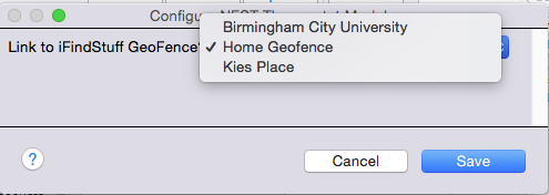

    Installing this plugin will provide you with some new functionality for each device; both Protects and Thermostats. If you edit one of your devices and click Edit Device Configuration... you'll be presented with a simple dialog where you can select an iFindStuff GeoFence as your location.

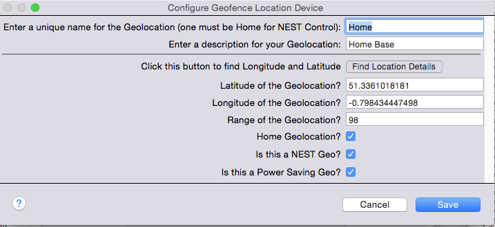

    Obviously iFindStuff must be running or nothing will be displayed in the drop down. You must also have designated a GeoFence as a NEST Geo in the iFindStuff configuration. Like this:

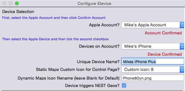

    Finally you need to tell iFindStuff which iDevices it should allow to tell NEST Home when it's entered a NEST GeoFence.

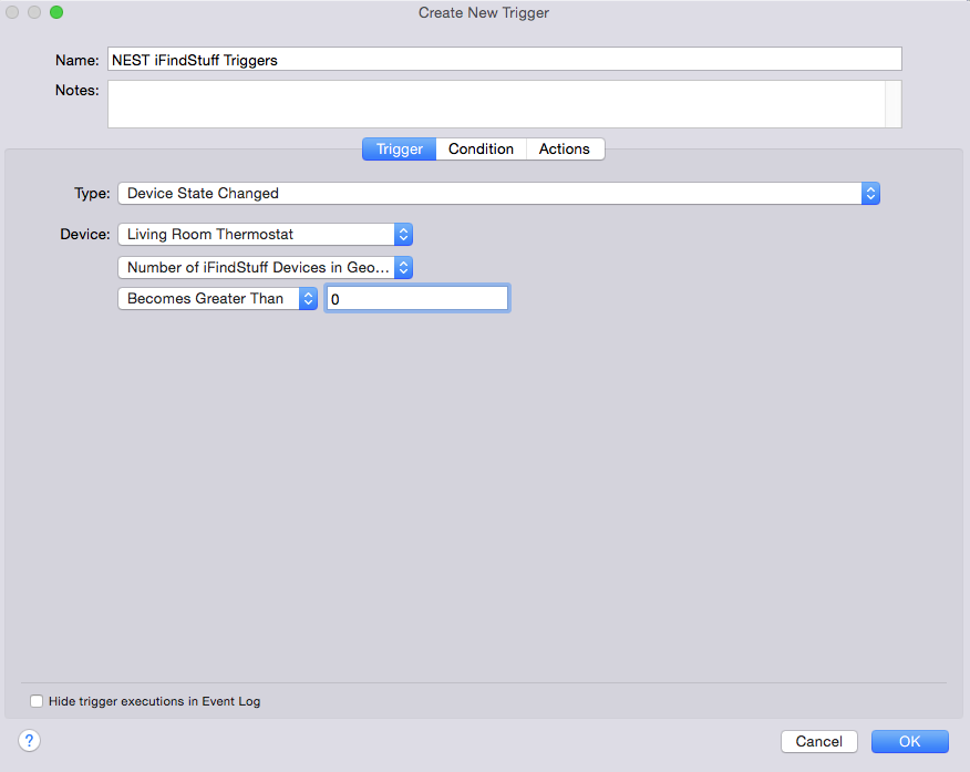

You'll find that you can use these new states as triggers for your NEST devices.
Trigger from Protect
Screen Shot 2015-09-21 at 16.43.24.png (57.03 KiB) Viewed 897 times
In this example I've changed the NEST ThermoStat status to 'Home' when an iDevice enters the NEST GeoFence assigned to it.
You could set the NEST to away when the number of iDevices detected is zero or only send an email to a device if there's a problem with a Protect and no one is in the house.
You can even send a message to an iPhone using the iFindStuff Command Send a Message as an action to a trigger.

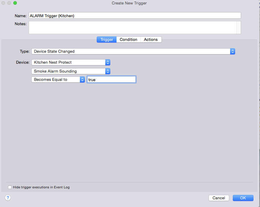

Here I've set a trigger for the Kitchen Protect when the alarm sounds.

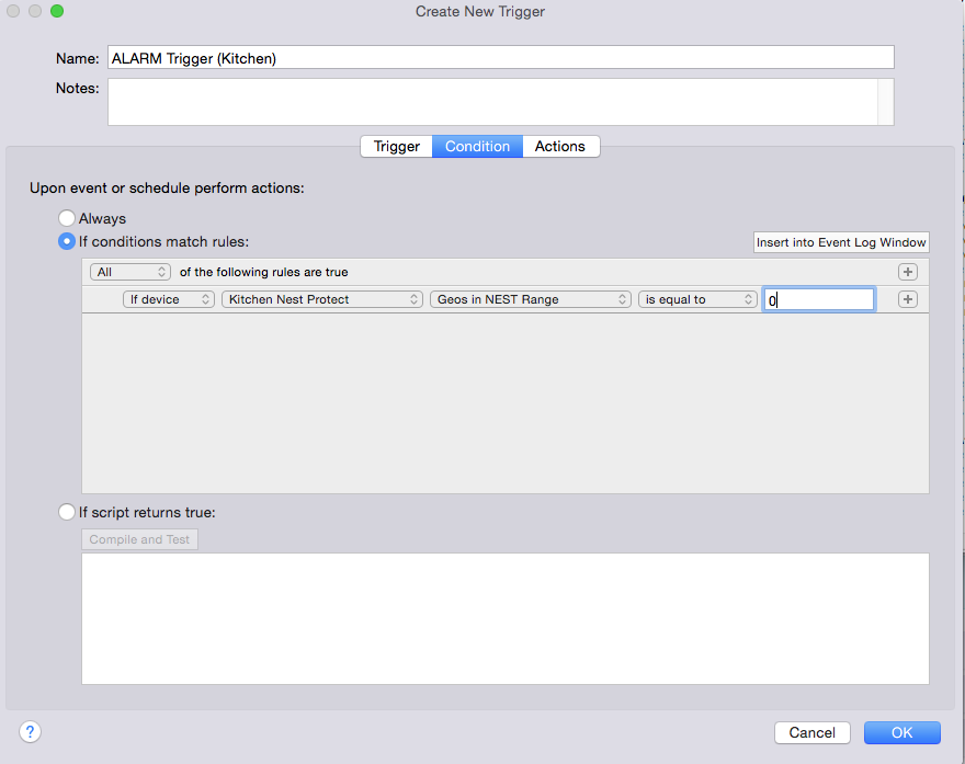

Then set a condition that 'if no one is at home'

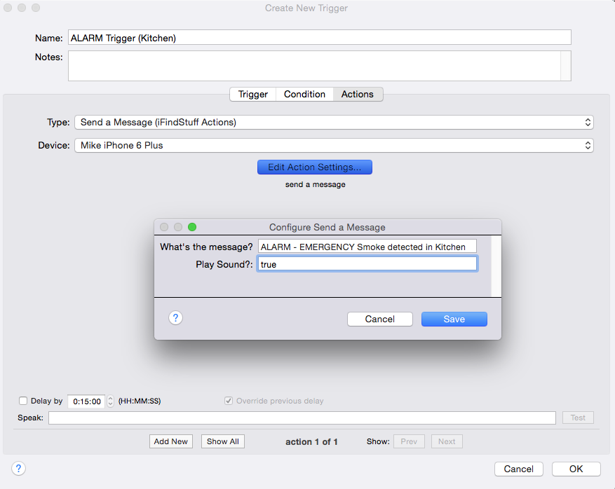

Then an iFindStuff action to carry out - in this case a TEXT message with a persistent sound (Note: If you use the Sound Feature it will keep sounding until the phone user acknowledges it on screen so use carefully!)
