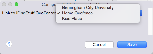

Installing this plugin will provide you with some new functionality for each device; both Protects and Thermostats. If you edit one of your devices and click Edit Device Configuration... you'll be presented with a simple dialog where you can select an iFindStuff GeoFence as your location.
NEST Home Device Configuration

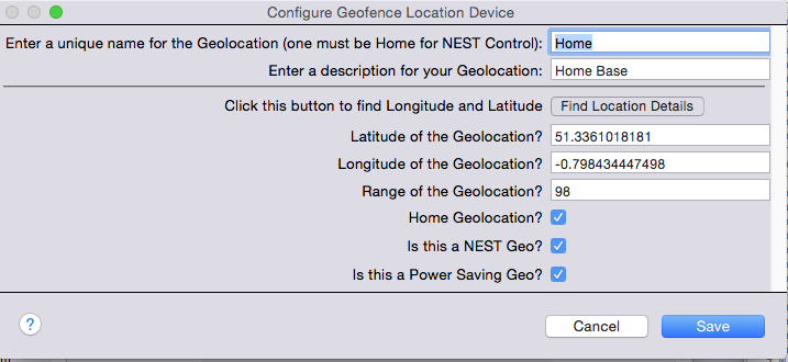

Obviously iFindStuff must be running or nothing will be displayed in the drop down. You must also have designated a GeoFence as a NEST Geo in the iFindStuff configuration. Like this:
iFindStuff GeoFence Configuration

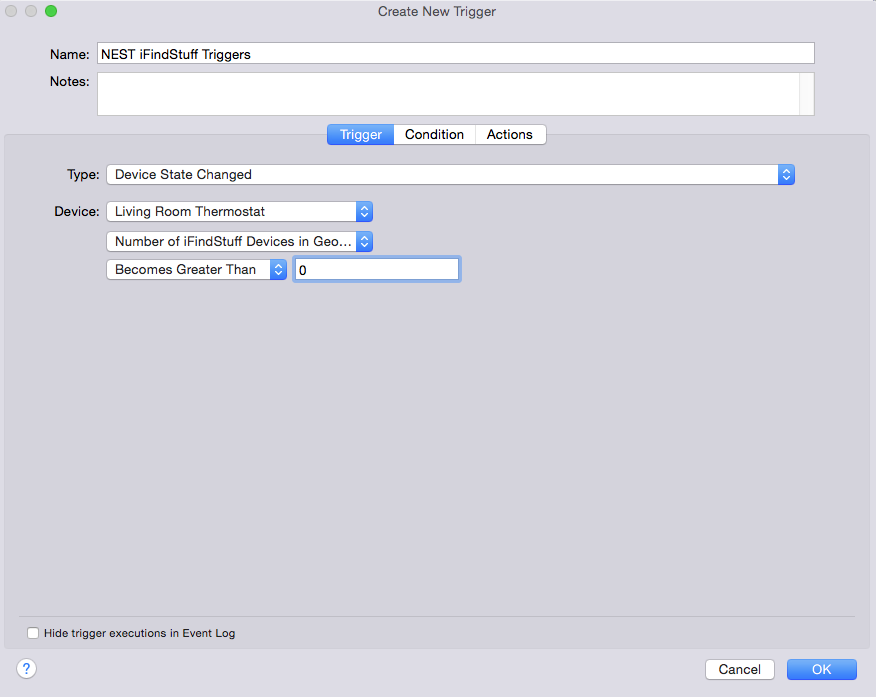

You'll find that you can use these new states as triggers for your NEST devices.
Triggers and iFindStuff
Screen Shot 2015-09-21 at 16.34.56.png (55.99 KiB) Viewed 9745 times
In this example I've changed the NEST ThermoStat status to 'Home' when an iDevice enters the NEST GeoFence assigned to it.

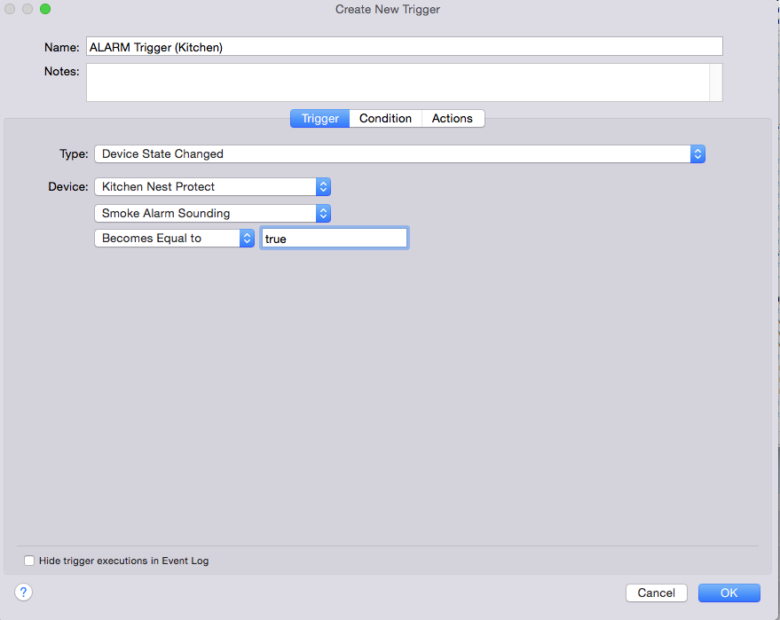

Here I've set a trigger for the Kitchen Protect when the alarm sounds.
Trigger from Protect

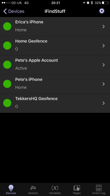

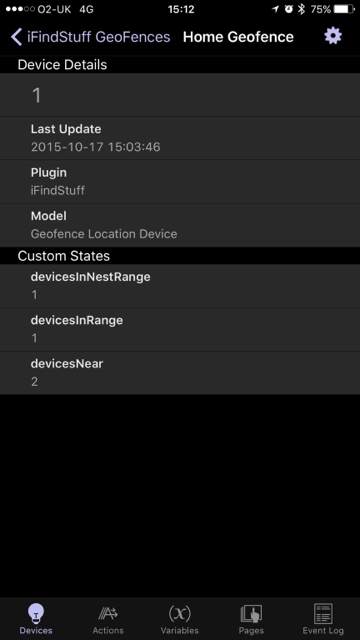

So - question. Me and my wife are both about 2 miles away from home. The geofence around my house is around 150m. But it's still thinks we're at home. How do I troubleshoot that?
petematheson
Posts: 847
Joined: Sun Sep 14, 2014 9:51 am
Location: Southampton, UK
Re: Latest Versions 2.0.20 released with GeoFencing!
Post by petematheson »
Also strange, devices both report being at home. However geofence thinks just 1 is.
petematheson
Posts: 847
Ah I think I've just cottoned on to something. If the device isn't at a geolocation it doesn't update to say something else.
I've just made the geofence smaller for my home and it seems to have updated this time to say we're not home.
