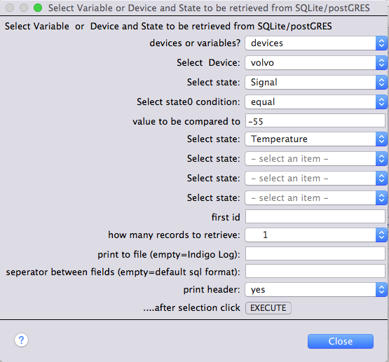

1. print the last record where state "signal" has value = -55
Screen Shot 2015-09-14 at 1.24.50 PM.png (83.36 KiB) Viewed 13942 times
creates this output:
id          strftime('%Y-%m-%d-%H:%M:%S',ts,'localtime')  signal      temperature
3378        2015-07-23-08:09:21                           -55         26.36

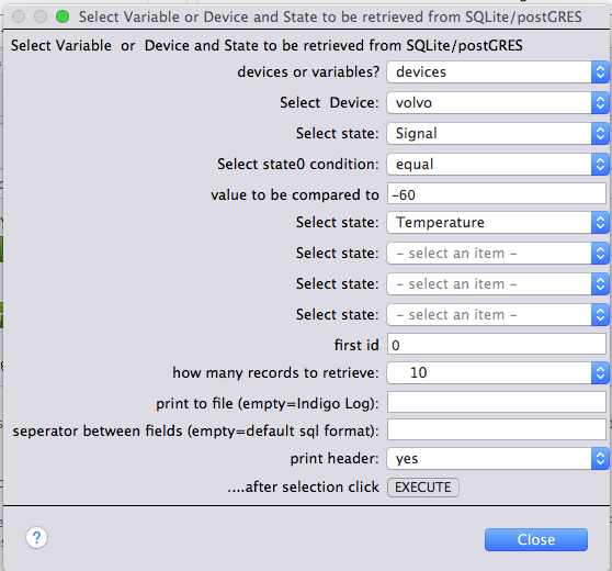

2. and this would print the first 10 records with signal value = "-60"
Screen Shot 2015-09-14 at 1.33.27 PM.png (85.7 KiB) Viewed 13942 times
467         2015-07-22-22:47:33                           -60         24.89
468         2015-07-22-22:47:33                           -60         24.89
469         2015-07-22-22:47:33                           -60         24.89
470         2015-07-22-22:47:33                           -60         24.89
471         2015-07-22-22:47:33                           -60         24.89
472         2015-07-22-22:47:33                           -60         24.89
473         2015-07-22-22:47:47                           -60         24.89
474         2015-07-22-22:47:50                           -60         24.89
475         2015-07-22-22:47:50                           -60         24.89
476         2015-07-22-22:48:12                           -60         24.89
