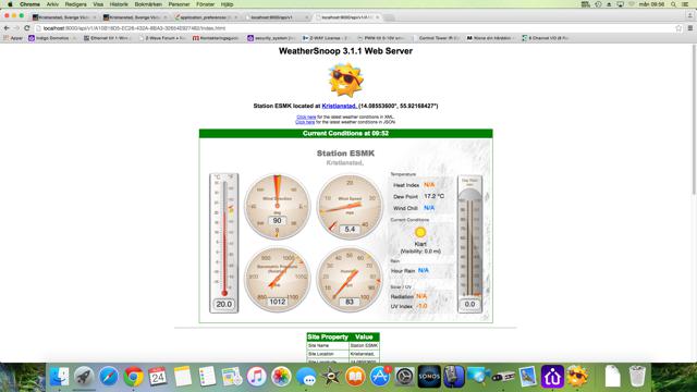

Re: Weathersnoop communication broken with 6.1.3
Now a have 2.0.9
But this error
Weather snoop agent working but not when importing it to indingo
- Skärmavbild 2015-08-24 kl. 09.56.04.jpg (29.84 KiB) Viewed 6452 times
