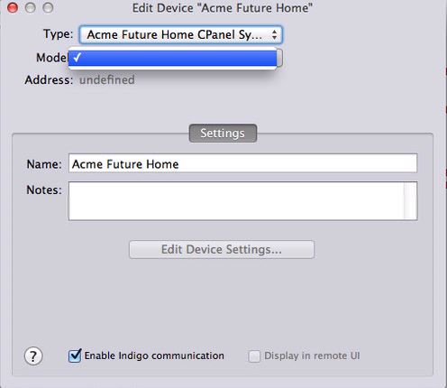

I'm loving the ROM collection, but have not been able to get the plugin working. I get a blank dropdown for the model:
I'm using Indigo 6.1.2 running on OS X 10.8.5 w/ Mac OS Server (which is why I've not upgraded).
Is anyone else having similar issues?

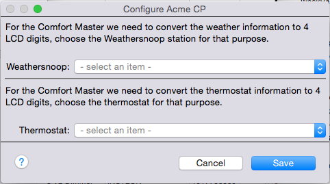

The devices plugin settings ask that you connect to a weather snoop device and a thermostat, I wonder if the lack of having one of these for some reason causes the device to just not show up. I would expect it would just not populate the combo-box but maybe it has a different effect.

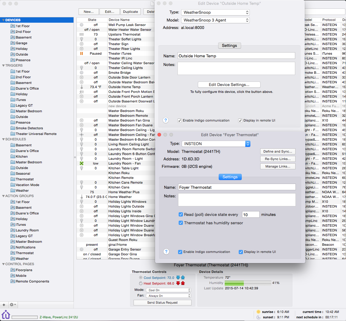

Hmmm. I do have a weather snoop device and thermostat defined... but my setup might be a little weird:
Screen Shot 2015-07-14 at 10.42.41 AM.png (490.24 KiB) Viewed 17582 times

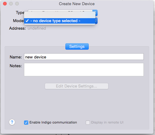

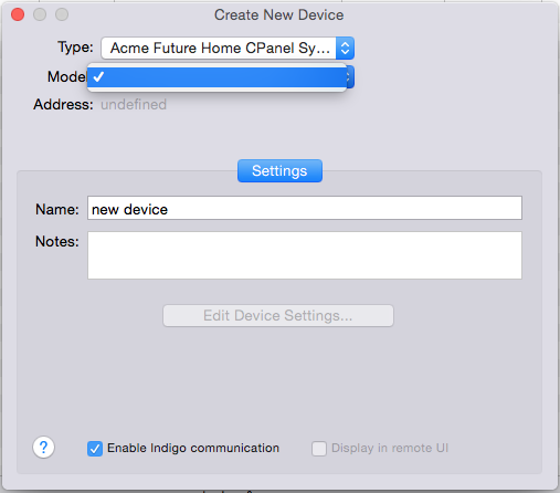

I also noticed that "no device type selected" is in the dropdown when I first try to set up the plugin:
Screen Shot 2015-07-14 at 10.51.00 AM.png (43.17 KiB) Viewed 17582 times
Then disappears once I choose the blank option above it and I'm unable to Edit Device Settings... (but that might be default behavior):
Screen Shot 2015-07-14 at 10.51.10 AM.png (41.67 KiB) Viewed 17582 times
