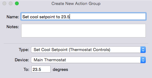

Your plugin allows the creation of an action group to set the cool set point or heat set point to a specific numerical value, 23.5 degrees in the example below. So, to schedule different set points at specific times of the day one needs to create a series of action groups — one action group for each specific temperature — then invoke the appropriate action group when required.
Alternatively, can a single action group be created to set the set point from the value of a variable? That is, can I use an embedded Python script in an action group to set the set point? If that's possible, would you kindly share some Python code to do this. If it's not yet possible, would you consider this as an enhancement request. Thanks.

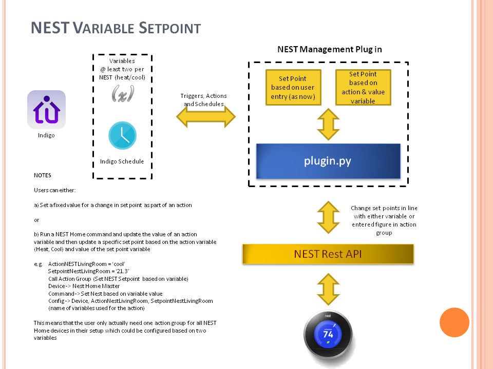

I've thought about what you're saying and I just want to confirm the use case.
This is what I think you're asking for:
NEST Indigo Variable Set point Action Manager
NEST Indigo Variable Setpoint.png (80.1 KiB) Viewed 2173 times
If so I'll update NEST Home over the next day or so and let you test it before I release it to a more general population.
It's a very good idea though. I hate having so many action groups in my list and this would be a great space saver :D

It turns out that the ThermostatDevice class of the Indigo IOM provides a means to do this and it works because the Nest Thermostat Module is a ThermostatDevice object.
So, in Python
var = indigo.variables[576243972] # "scheduled_temperature"
coolSet = var.getValue(float)
indigo.thermostat.setCoolSetpoint("Main Thermostat", value=coolSet)
Or, in AppleScript
set coolSet to value of variable "scheduled_temperature"
set cool setpoint of device "Main Thermostat" to coolSet
I created an action to execute that embedded code. My temperature scheduler sets the scheduled_temperature variable then calls the action. This seems to work perfectly and is cleaner than calling one of several actions to set a specific temperature value.
