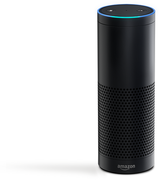

Amazon just announced a new toy!
Amazon Echo
http://www.amazon.com/oc/echo
Amazon Echo is designed around your voice. It's always on—just ask for information, music, news, weather, and more. Echo begins working as soon as it hears you say the wake word, "Alexa." It's also an expertly-tuned speaker that can fill any room with immersive sound. Tucked under Echo's light ring is an array of seven microphones. These sensors use beam-forming technology to hear you from any direction. With enhanced noise cancellation, Echo can hear you ask a question even while it's playing music. Echo's brain is in the cloud, running on Amazon Web Services so it continually learns and adds more functionality over time. The more you use Echo, the more it adapts to your speech patterns, vocabulary, and personal preferences. Echo has been fine-tuned to deliver crisp vocals with dynamic bass response. Its dual downward-firing speakers produce 360° omni-directional audio to fill the room with immersive sound. Echo provides hands-free voice control for Amazon Music, Prime Music, iHeartRadio, and TuneIn. Plus, Echo is Bluetooth-enabled so you can stream your favorite music services like Spotify, iTunes, and Pandora from your phone or tablet. Echo doesn't stop working when you're away from home. With the free companion app on Fire OS and Android, plus desktop and iOS browsers, you can easily manage your alarms, music, shopping lists, and more.
Amazon Echo
