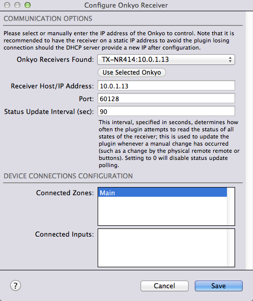

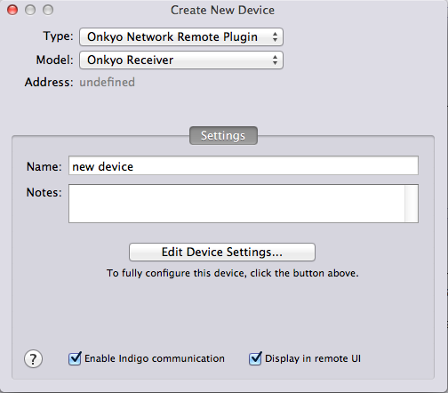

Re: Onkyo Network Remote Feedback and Discussion
Hi Adam,
That seems to be the very problem that I don't get any inputs in the Device Configuration screen unless I am doing something wrong. Attached are pics for clarity and log file entry:
- 27 Jul 2014 2:32:54 pm
Onkyo Network Remote Plugin Error Error in plugin execution GetUiDynamicList:
File "plugin.py", line 108, in getInputSelectorMenu
<type 'exceptions.KeyError'>: (290398102,)
- Screen Shot 2014-07-27 at 2.29.28 pm.png (72.46 KiB) Viewed 9137 times
- Screen Shot 2014-07-27 at 2.28.59 pm.png (39.27 KiB) Viewed 9137 times
No, likely both are the same issue and this is a bug in the plugin... hence the beta tag
I'll take a look and fix it up -- should be able to take a look tonight and figure it out. Will post back with what I find and/or the fix.
Okay, duplicated and fixed this issue - it was a fairly easy find/fix once your details were posted, so was able to quickly knock it out. Let me know if this fixes it for you (should...) and if we need to look into anything more I will be available to debug more tonight.
