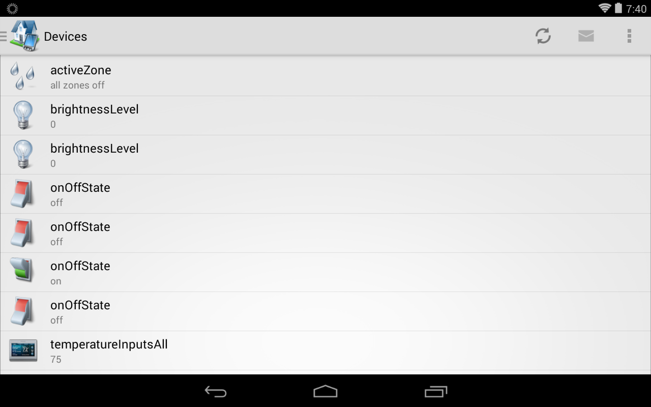

Nice work on the client. I just installed on a 1st Gen Nexus 7 and everything seems ok with exception that the device names don't show, rather more like a device type is shown.

That is exactly what I was describing as the bug I was trying to track down -- not sure now on any new installs, but during the initial beta it affected 2 people out of about 12 or 13.
If it is still doing it for you, would you mind hitting the menu button and choosing Help then select to Send Debug? This will send the following information:

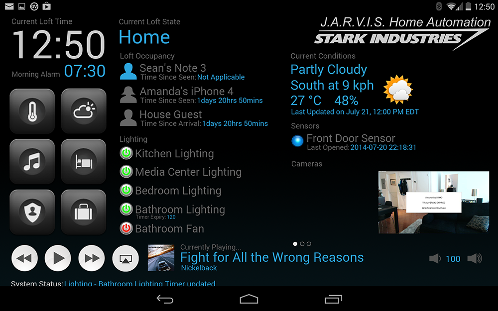

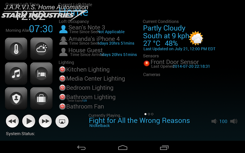

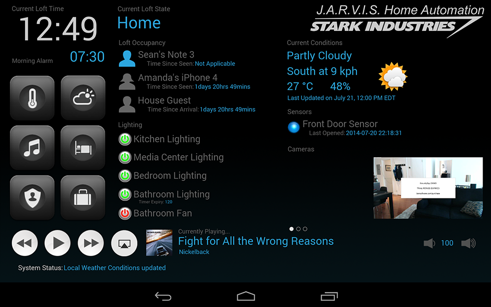

So first off I have to give huge credit on the app, it has actually fully replaced my browser based use of the control pages on my android devices and actually has me preferring it over the Indigo Touch UI on my iPad (sorry Jay). However, I have run into an issue when using my control pages on my Nexus 7. While the control pages render properly on my Galaxy Note 3, the text sizes and placement are rendered incorrectly on the Nexus 7. (See below, correct placement above, incorrect rendering in HousePad below) Also the native view mode for the control pages is far worse then that on every android device I own and doesn't even display the smart image graphics correctly, this can be seen at the very bottom.
The correct layout, spacing and font sizes
The way HousePad displays my control pages in web display mode on the Nexus 7
