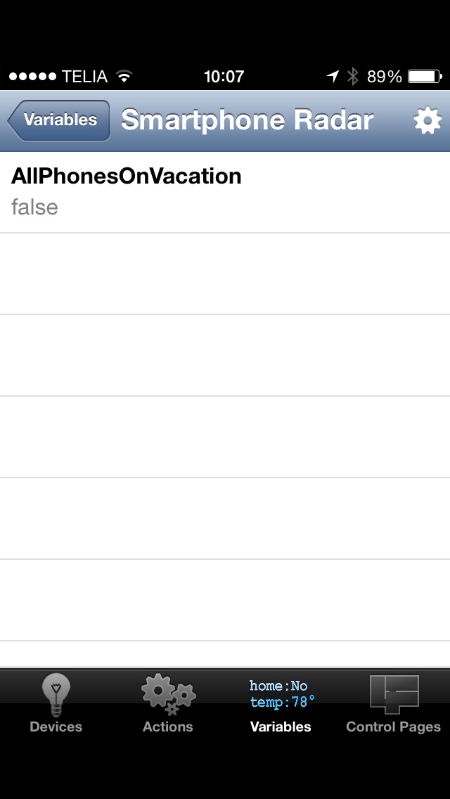

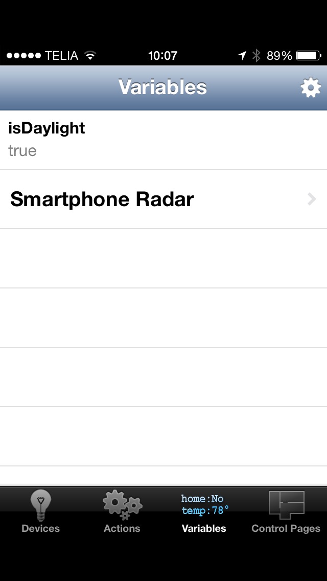

Below are some screen-shots from the iPhone App. I have (re)created a folder call Smartphone Radar and moved the variables there.
Note, when on my home network all variables show up in the right place, both in the app and on the mac.
Cheers/Carl
Cheers/Carl

Re: [ANSWERED] Variables missing in Indigo Touch
Could it be that reflector is lookin at the wrong server? But then why does the folder appear..... Very strange, someone call mulder and scully!
