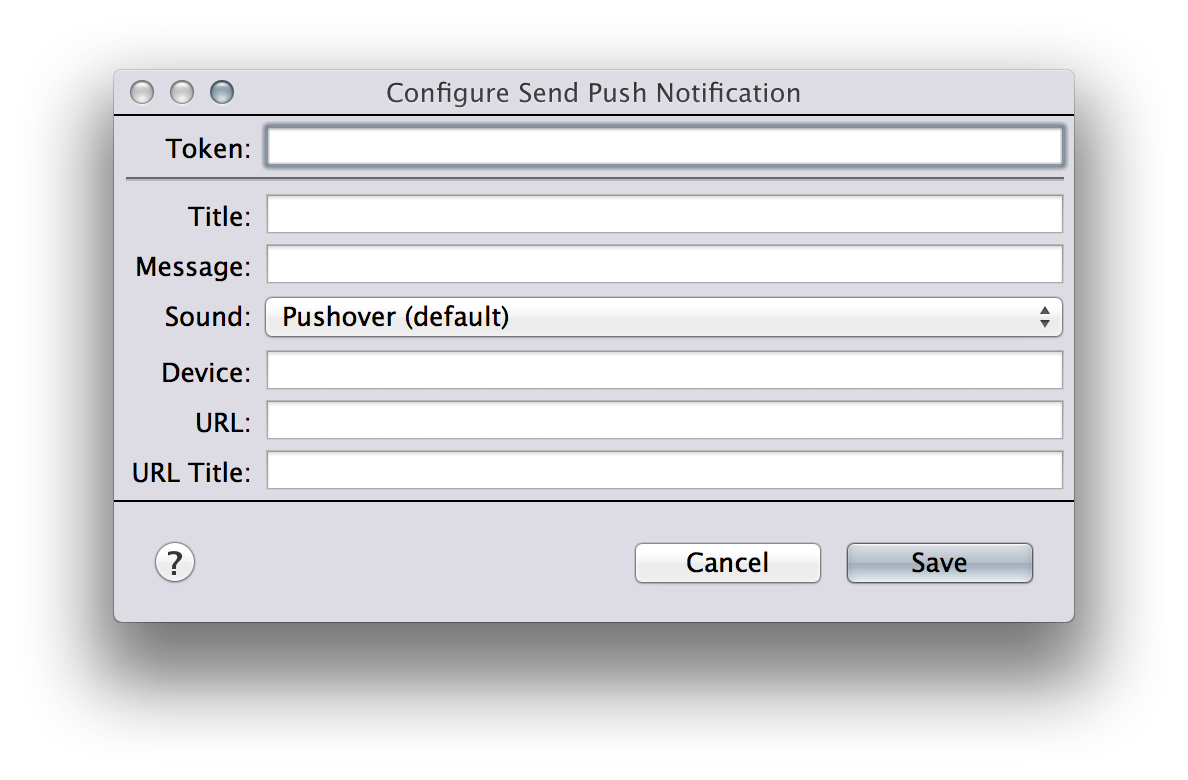

I created my own version of this plugin with support to send the message to (only) one device or all devices when the field is emptily.
I notified the developer through github and will discuss with him what/how he wants to integrate what I created.
My new version does (also see screen shot):
- custom application api (or default when empty)
- title
- message
- sound (selected default sound)
- device (can be empty)
- url (can be empty)
- url title (can be empty)
- use indigo variable within title and message (also nested variable within a variable is replaced)
Cheers,
Marcel
- title
- message
Cheers,
Marcel
- Screen Shot 2014-04-02 at 21.50.35.png (102.04 KiB) Viewed 14877 times

Looking forward to this!marceltrapman wrote:I created my own version of this plugin with support to send the message to (only) one device or all devices when the field is emptily.
- title
- message
Cheers,
Marcel
Thanks!
