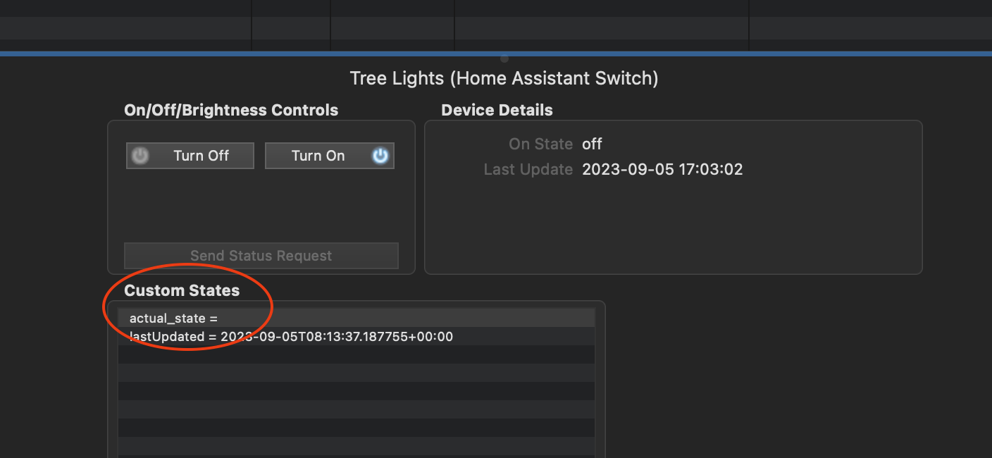

You want the "actual_state" custom state. You can see it in the UI:
HAA currently does not have an option to import "Person" entities. There's lots of GeoTracking options in Indigo, so I didn't bother adding that to the plugin.

- Posts: 7830
Re: Home Assistant plugin updated for Python 3
The only actual errors there are these lines:
To fix those, just edit the devices and save them (no changes needed). The other line is debug information, not an error. Just turn off debug logging unless directed to turn it back on.
Error device "SpaHeaterHA" state key actual_state not defined (ignoring update request)
Error device "Main Thermostat HA" state key actual_state not defined (ignoring update request)

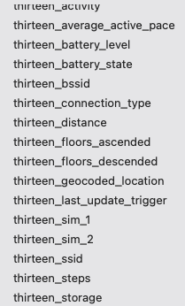

I'm finding a LOT of power in HASS. it's quite amazing. Thanks very much for this plugin!
There's an integration with iPhones that lets HASS see a lot of phone info, including "Focus". While many of the phone value sensors are visible to Indigo, Focus is not.
Is there some technical reason this isn't available? It seems like a natural one to trigger all sorts of automations with.
Also, for anyone looking for geolocation using phones, the HASS plugin seems like the easiest way to do it--and that's speaking as someone who already uses the Unifi plugin for it, FindFriendsMini for it, and has tried various beacon solutions too!
(in the attached screen shot "thirteen" is my iPhone, and if Focus was available, it should be on the menu.)
- Screenshot 2023-09-15 at 8.52.30 AM.png (21.29 KiB) Viewed 2778 times

- Posts: 7830
The HAA plugin only supports a limited set of HA device classes that have a reasonably direct counterpart in Indigo. While it’s not that difficult to add more classes, what to map them to in Indigo is the issue. I’m certainly open to adding more mappings, but I’m not going to add dozens of them. I’d need to see some sort of proposal of what the mapping should look like.Different Computers wrote: Is there some technical reason this isn't available? It seems like a natural one to trigger all sorts of automations

The newest plugin seems to have missed populating the pull down and Entities not populating the entity pull down data field inside the device window I have only a couple of devices instead of the like 15-20 devices that should come up. what's the best way to keep the entries but update to contain them in the pull down?
Daniel
Daniel
- Posts: 7830
What device types are missing from the list? As described above, only a limited set of device types are currently supported.EagleDTW wrote:Hi Flying Diver,
