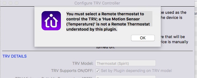

Soooooo close let's me select the Hue Temp Sensor then....

Busta999 wrote:Soooooo close let's me select the Hue Temp Sensor then....
Back on the case ..... :)
