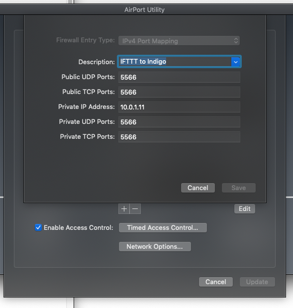

Re: HTTPd Plugin (useful for IFTTT Maker integration)
And here is a snapshot of my router configuration inside Apple's Airport Utility. It's the same as I've used for the last year or so. Maybe it doesn't like my settings anymore? As usual, thank you.

- Posts: 7830
All that looks normal. The failure to quit is not unusual. I think I improved that in later versions, but I need to check.

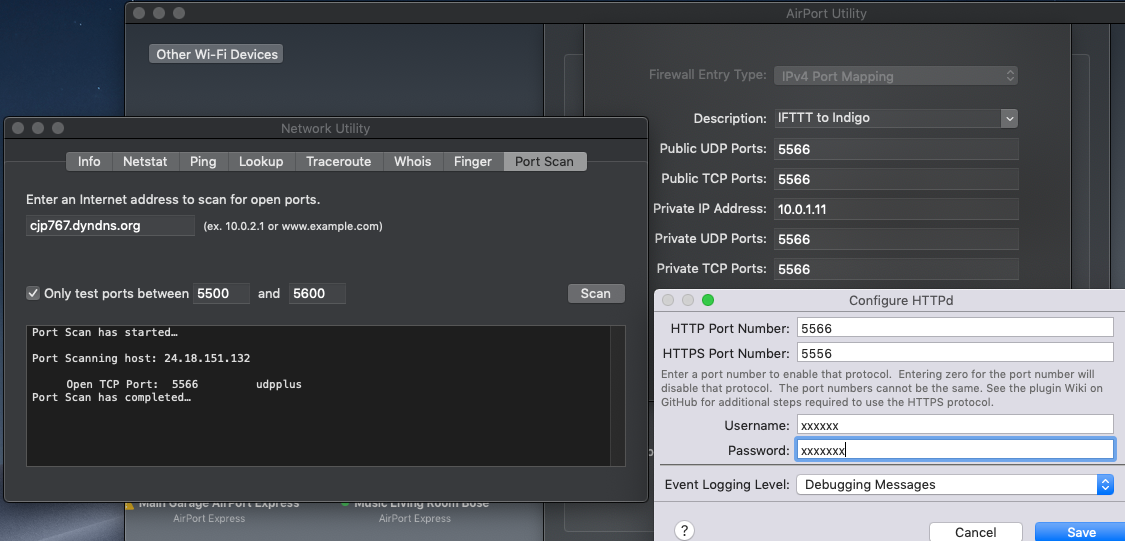

As a final summary, before I pull my remaining hair out, here is a screen shot of the players-- Network Utility shows my address resolved properly with port 5566 open. My Airport Utility shows TCP Port 5566 sent to my MacPro that lives on my network at 10.0.1.11. And finally, the settings for the HTTPd plugin are shown, with the userid/password x'd out. This has worked for the last year or so... I'm missing something very basic. Unless Comcast has locked port 5566-- or should I adjust the port forward?
And now this, from the log. It' s a successful variable change. It happened while I was taking the screen shots-- And I don't know where it came from (probably an earlier request). Now I'm more confused. I'll see what happens throughout the day. But something started to work.
Mar 17, 2019 at 10:33:46
HTTPd Debug AuthHandler: GET from 24.18.151.132:46862 for /setvar?var1test=yay
HTTPd Debug AuthHandler: Request has correct Authorization header
HTTPd Debug AuthHandler: setting variable httpd_var1test to 'yay'
- Screen Shot 2019-03-17 at 10.32.27.png (384.76 KiB) Viewed 4740 times
That GET looks like it came from your IP address, so I’m thinking that was the curl command. Which leads me to think that there’s something going on with IFTTT.
