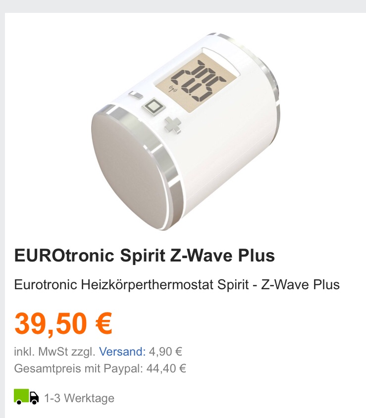

Sevilsivle wrote:May I ask where you bought them?
Yes :)
Z-Wave Eurotronic Spirit Smart Radiator Thermostat
Sevilsivle
Posts: 123
Joined: Fri Jan 11, 2013 12:32 am
Re: Autolog Stella-Z Thermostat Controller Discussion
Post by Sevilsivle »
Yes :)
Yikes....
At that price I guess it is worth waiting for them to become available here in Germany...
Tim

Sevilsivle
Posts: 123
autolog wrote:Do they ship to the UK :?:
You have Mail!
