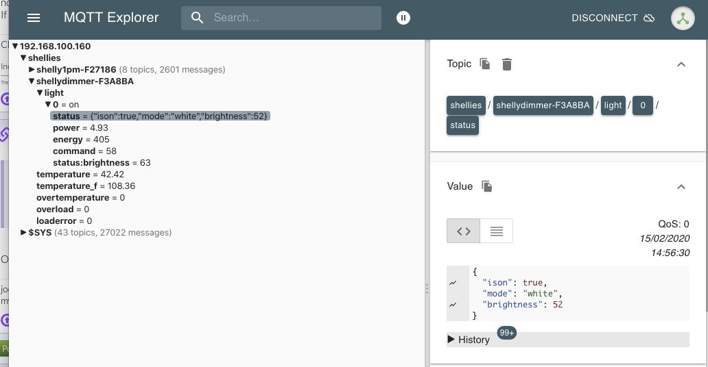

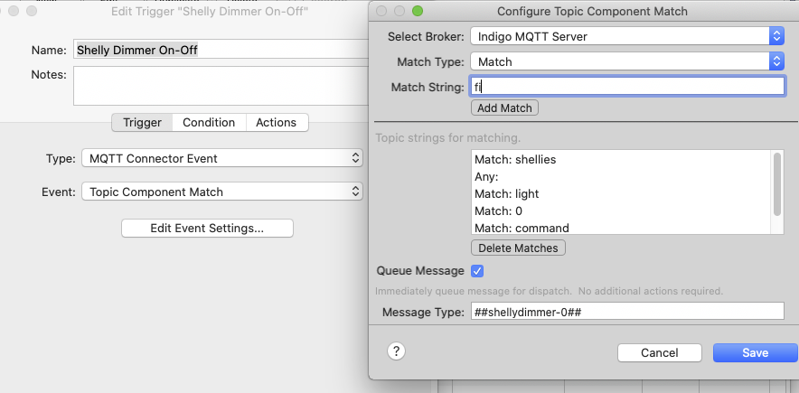

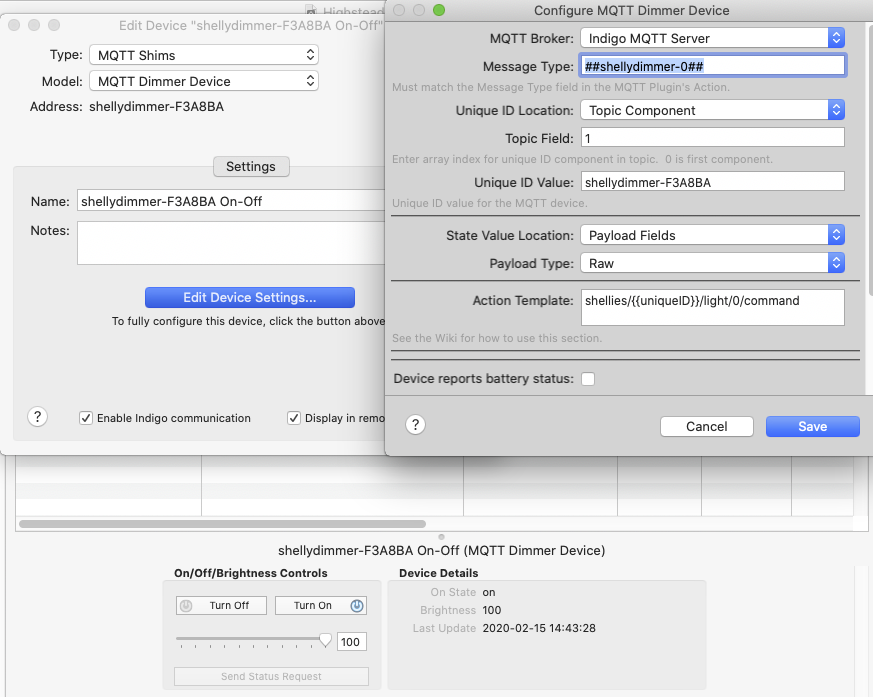

OK, show a screen grab of your connector trigger and your shim device configuration. And an MQTT Explorer screenshot of the message sent by the iOS app if possible.CliveS wrote: If I turn on the dimmer it shows 100, turn it off it shows 0, click anywhere on the dimmer bar and it gives the value in the UI but the slider flicks back to full on and the bulb does not register any change.

First, your trigger is wrong. You're trying to trigger on the command sent to the device. You need to trigger on the status update from the device, which is what you show in the MQTT Explorer image:
Second, your payload type is wrong. As you can see in the Explorer output, that payload is JSON. With a key of "brightness".
Your action template looks correct for turning the device on and off. I need to check the code to see how you would set the brightness. If you can at all right now. I don't remember.
Match: shellies
Any:
Match: light
Match: 0
Match: status
End:

Re: Using Shelly devices with the MQTT plugin
Yes my message did not make much sense re-reading it, I think the delay of the iPhone showing on/off is due to the shelly app and not shims as that is reacting immediately.
I did make the changes and the log reflects it is
"updating from the iPhone" means I move the shelly app dimmer bar left and right and that is reflected in the UI immediately but as you say does not get sent to the device.
I did manage to get all the date imported into GhostXML as JSON by using http://xx.xx.xx.xx/status, not sure if that is helpful or not.
MQTT Shims Debug shellydimmer-F3A8BA On-Off: state = 38
MQTT Shims Debug shellydimmer-F3A8BA On-Off: shimDimmer, state_key = brightness, value_key = brightness, data = {u'brightness': 38, u'mode': u'white', u'ison': False}, state = 38, value = 38
MQTT Shims Debug shellydimmer-F3A8BA On-Off: Updating brightnessLevel to 38
