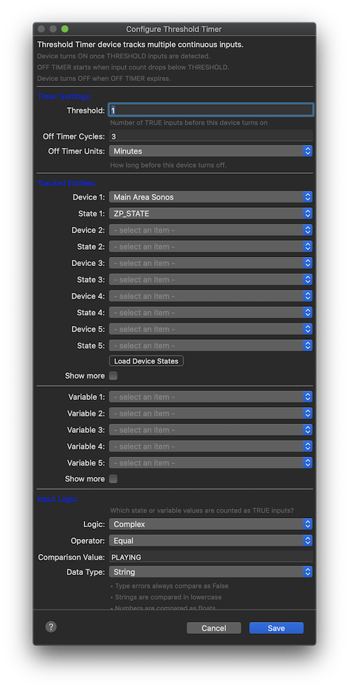

I updated to the latest version of the plugin and one of my Threshold Timers is no longer working. Here's a screenshot of the config for that device. I reverted to the previous version and it's working again.

Hi vtmikel.
I set up a timer like yours but am unable to reproduce the issue. It what manner is it not working?

Sorry for the delay.
The device I took a screen shot of was a device I had set up using your plugin under a past version, and is now not working.
To test, I also created a new device, using the exact same setup. I notice that I get an error that "count out of sync [count:-1, max:1]" on the freshly created device. It also never turns "ON". In my test case, it is a threshold timer set to Sonos speaker's ZP_STATE, which is the field where it will say "PLAYING" if the Sonos is playing. Under the new version of the plugin, it does not turn on (the legacy threshold device, as well as the newly created device). On the past version of the plugin, it does trigger to on when the Sonos is playing, and begins a countdown to turn off based on the threshold amount. I use this to avoid unnecessary triggers during short pauses in my music.
Not sure what else to provide to reproduce?

Re: Timed Devices plugin
Sorry for my delay as well.
Unlike the other device types Threshold Timers keep an internal tally of your tracked device state and the error you are getting indicates that it is getting out of sync with the Indigo Server. Usually this a communication error and it will get back in sync after the error message. I don't understand why it keeps recurring in your case.

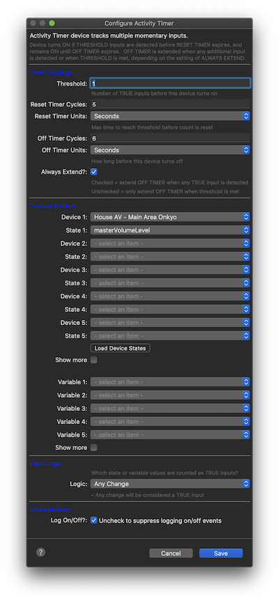

Turning off verbose removed the crashes. And, the Threshold Timer that I previously had trouble with is now working. However, an Activity Timer that was previously working is not, I've attached the screenshot for the device config. No significant information in the Log to share, and I can see that the state value for the device I've attached to the Activity Timer is changing, but the device is not triggering.
