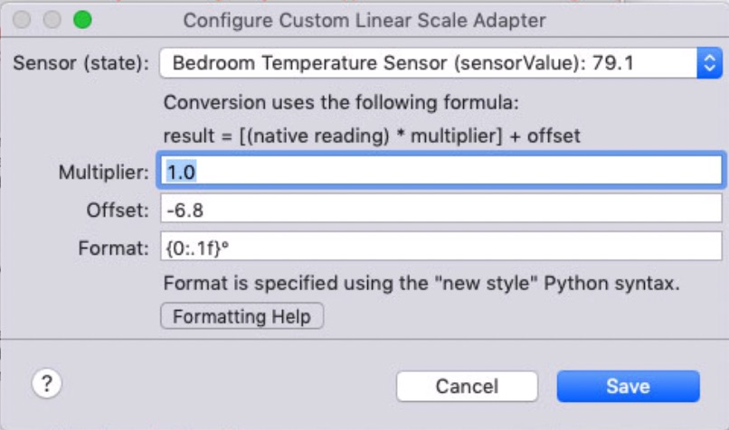

Not sure what's causing the error, but it's working fine for me. Do your settings resemble these?

Dave, Thanks for the support. I put the parameters you recommended into the adapter. I assume the symbol for degree is option shift 8 on a Mac keyboard.

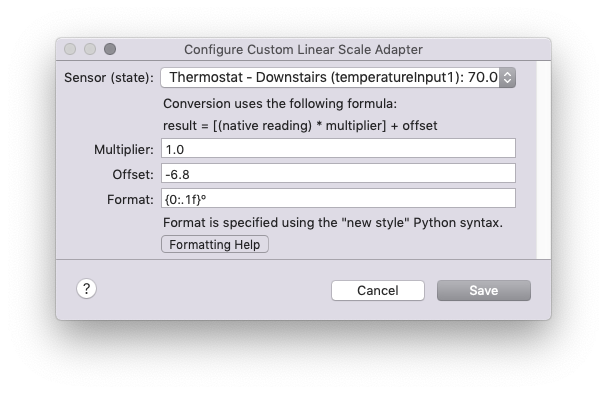

- Screen Shot 2019-06-09 at 1.29.53 PM.jpg (79.91 KiB) Viewed 9278 times

Dave,
So if these parameters work correctly on your system there must be something wrong with my Indigo setup.
