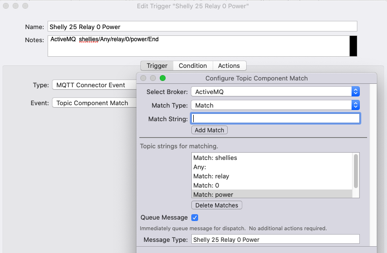

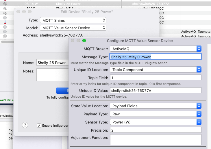

Colly,
Here are some screen shots of the power value set up for a Shelly 2.5.

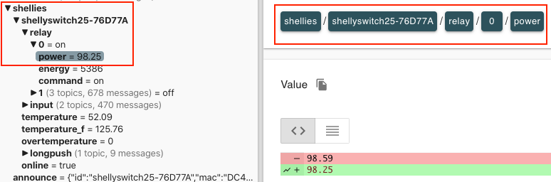

I always begin with MQTT Explorer to see what the device is subscribing to and to get the format:
Screen Shot 2020-02-01 at 9.34.19 AM.png (45.88 KiB) Viewed 4001 times
Trigger:
Note: Don'f forget to add the Topic Completion "End" Match (not showing in my screen capture)
Screen Shot 2020-02-01 at 9.42.53 AM.png (110.26 KiB) Viewed 4001 times
Shim Device:
Screen Shot 2020-02-01 at 9.46.29 AM.png (151.88 KiB) Viewed 4001 times
I like pictures so hope this helps.

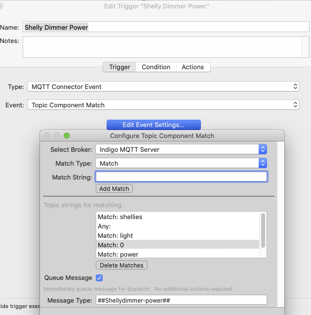

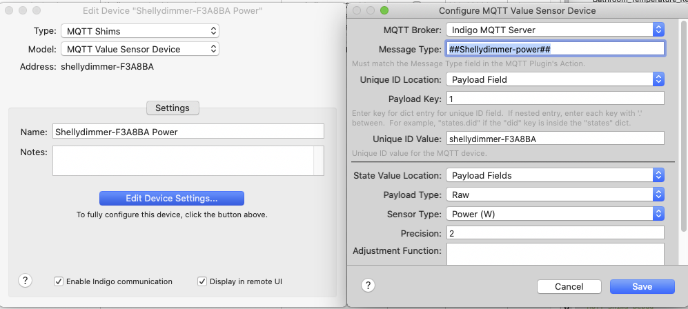

Error with Shelly Dimmer Power output
Post by CliveS »
Getting a strange error on a Shelly Dimmer, Energy gives correct amount but Power just errors in the log.

   MQTT Shims Debug                received notification of MQTT message type ##Shellydimmer-power## from Indigo MQTT Server
   MQTT Shims Debug                Shellydimmer-F3A8BA Power: processMessages: '##Shellydimmer-power##' shellies/shellydimmer-F3A8BA/light/0/power -> 4.90
   MQTT Shims Error                Shellydimmer-F3A8BA Power: update error determining device address field: 'float' object has no attribute '__getitem__'

CliveS
Re: Error with Shelly Dimmer Power output
CliveS wrote:Getting a strange error on a Shelly Dimmer, Energy gives correct amount but Power just errors in the log.
Moved to the Shelly thread...
Please turn off Detailed Debugging unless I specifically ask for it.
Show me the Shim Device configuration. And the payload. I suspect you have it set for JSON payload when it should be Raw.
CliveS
Posts: 864
Re: Using Shelly devices with the MQTT plugin
Post by CliveS »
Screenshot 2020-02-12 at 21.14.19.png (121.03 KiB) Viewed 3805 times
Screenshot 2020-02-12 at 21.16.00.png (92.21 KiB) Viewed 3805 times
CliveS
Do you have MQTT Explorer? Can you show me what the actual message looks like?
