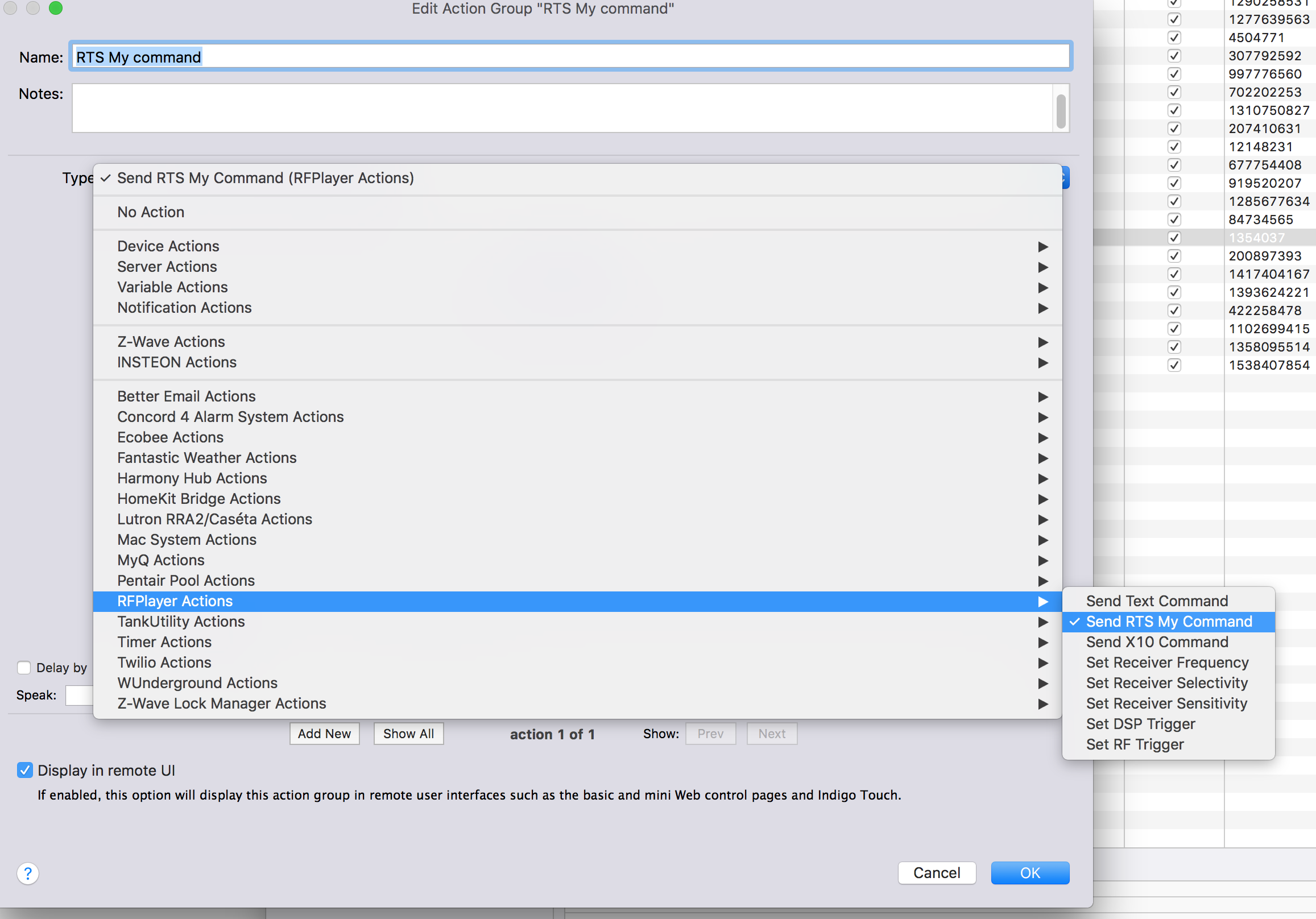

Wait. Are you trying to do that with the "send text command" action? Don't do that. There's a specific device action for the "My" command.
Screen Shot 2018-08-16 at 11.37.51 AM.png (531.76 KiB) Viewed 4794 times

yes I did that but it is sending an off command
not MY command so the blind just go all the way down
