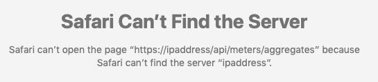

colovin
Posts: 175
Joined: Tue Oct 27, 2009 11:55 pm
Re: Tesla Battery Gateway Plugin
Post by colovin »
Have you tried the address posted above in web browser?
Yes, I've attached a screen shot of the result.
Indigo 7.1.1, OS 10.14.6, MacMini .3.2 GHz 6 Intel Core i7, 64 GB ram
