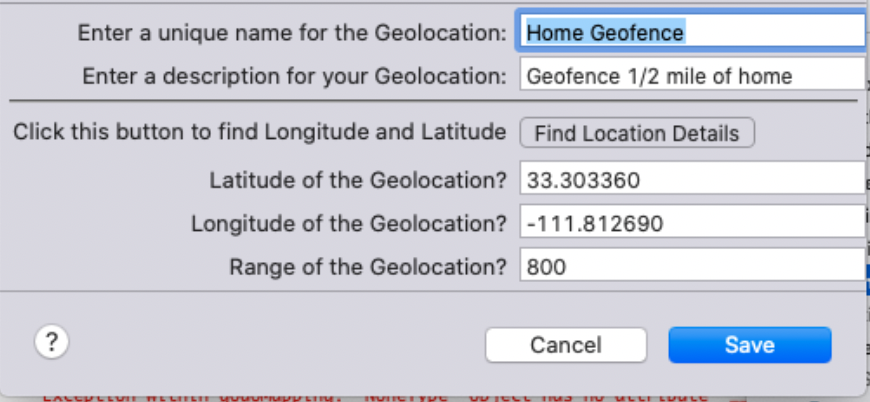

H Glenn,
Now I'm suddenly getting the following error message in the log every time the plugin updates the location information:
FindFriendsMini Error Exception within godoMapping: 'NoneType' object has no attribute '__getitem__'
File "plugin.py", line 1192, in godoMapping
fileMap = "curl --output '" + file + "' --url '" + drawUrl[0] + "'"
TypeError: 'NoneType' object has no attribute '__getitem__'
This was not happening earlier. I've attached a screen shot of my Geofence settings.
Thanks again,
Mike
Thanks again,
Mike
