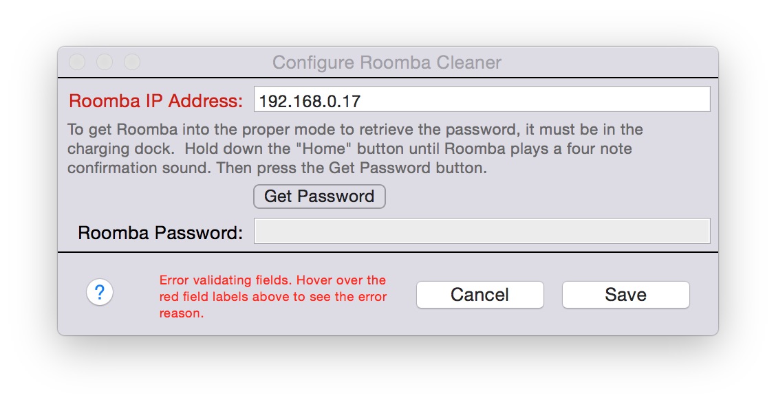

I just installed this plugin for my new Roomba (thanks!). Installed and runs fine, but it will not let me enter the device's IP address:
The IP address is correct, confirmed both by my router and the Roomba app. Doesn't matter whether the roomba is on or whether it is in discovery mode.
Here's the log:
Roomba Debug validateDeviceConfigUi called
Roomba Debug validateDeviceConfigUi: RequestException: HTTPSConnectionPool(host='192.168.0.17', port=443): Max retries exceeded with url: /umi (Caused by ConnectTimeoutError(<requests.packages.urllib3.connection.VerifiedHTTPSConnection object at 0x10ca528d0>, 'Connection to 192.168.0.17 timed out. (connect timeout=3.0)'))
The app on my phone works fine. Any ideas?

Yes.I have the flashing green WiFi fan. Wasn't clear to me whether setting the IP and getting the password was a single operation or two separate ones. I tried both. If I enter the IP address and press Get Password, I get the following:
Roomba Debug getRoombaPassword called
Roomba Error Unable to get Roomba Password. Ensure Roomba IP address is correct.
Re: Roomba Plugin - beta tests

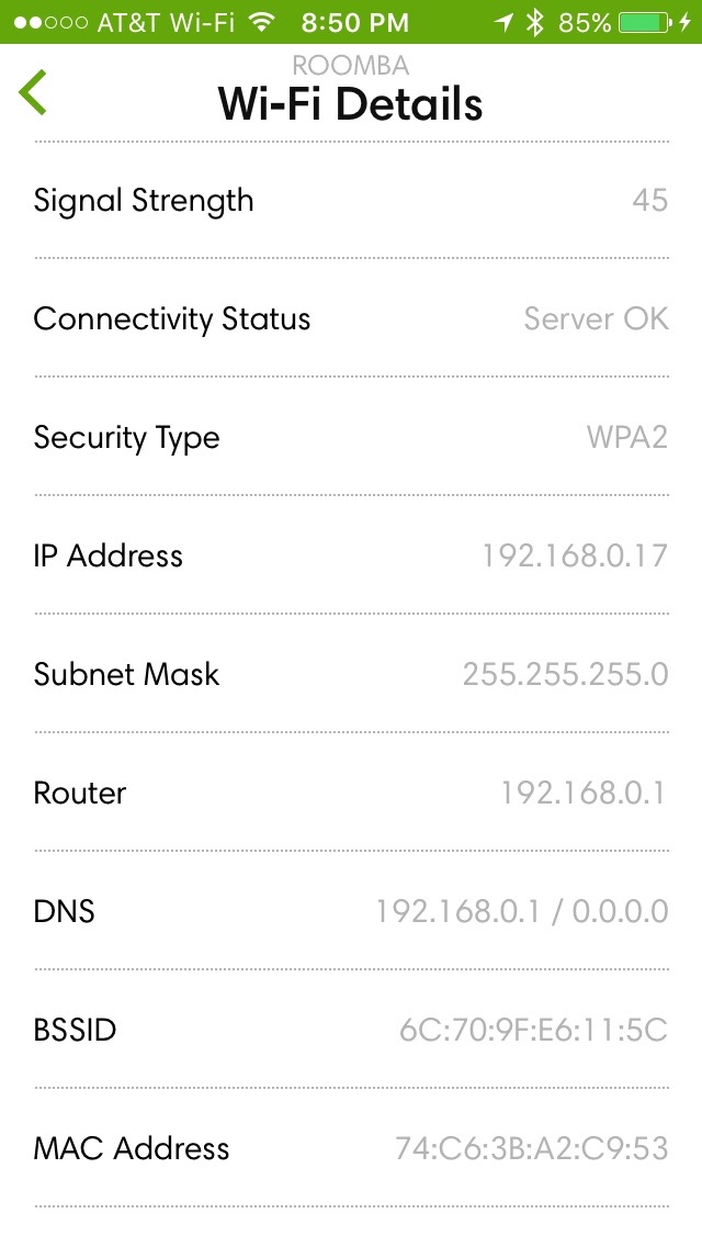

Can you post a screenshot of the Wi-Fi Details page in the iRobot app?
Also, make sure you don't have any leading or trailing spaces or other invisible character in the IP address field.
avanti
Posts: 7
Joined: Mon Jan 02, 2017 5:06 pm
Post by avanti »
Typed that IP address about 100 times. :?
