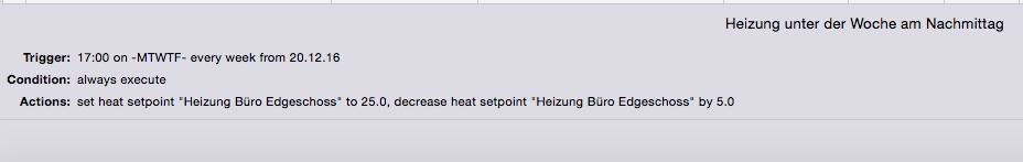

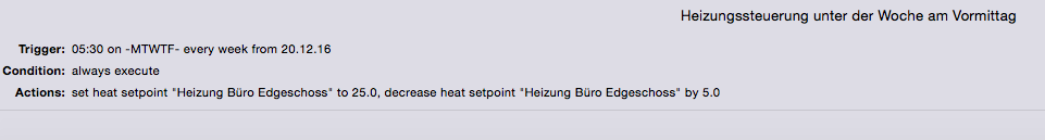

Well, I think something goes wrong here with the thermostat.
I've set up some schedules (day and evening), set up the heat points bu when when schedules are runnning can't see that the thermostat does something.
It should begin to start to heat, make a noise (the motor) and the radiator body should be warm.
Nothing happens.
Also, the room temperature is the same (around 21 degrees Celsius).
What I'm doing wrong?
The thermostat is synced and online.
Can someone help, please?
Thx,
Yassi

autolog
Posts: 4077
Location: West Sussex, UK
Re: Autolog Stella-Z Thermostat Controller Discussion
Post by autolog »
Hi Yassi,
What wake-up time (frequency) have you set the thermostats to?
Can you post log entries from when the schedule runs (just before and after), so we can see what Indigo is doing and the responses it gets. :)

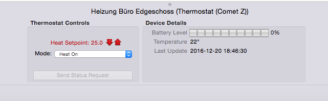

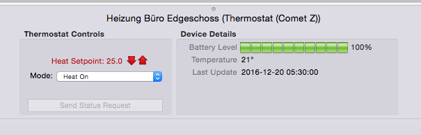

Hi Jon,
ok, but I didn't tooked out the batteries sinced I've installed it.
After your last post I've tooked out he batteries (tried before to manually adjust the temp via the know, to see if the motor moved, it didn't).
Then tried to resync it, had some errors because of the return route.
Now, the radiator body is warm, the schedule is running, but the batteries are empty (see screenshot)!!! This is not possible, ,they are only a week, last battery status was at 100%!
I saved the setting as is indicated to 5 minutes.
So, I don't know how long it will work now.
Yassi
