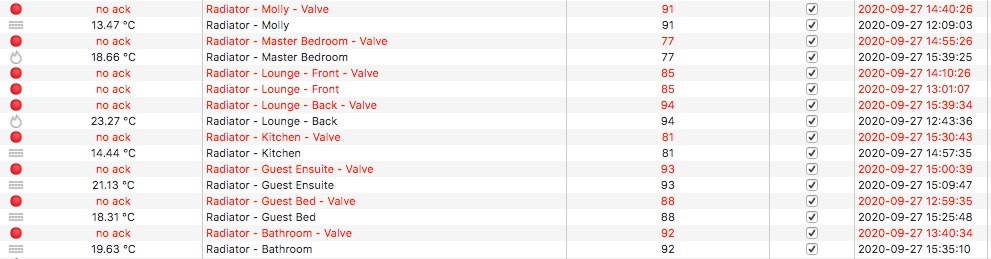

Large number of outages and TRV controller not turning on heat.
Went into my lounge was 17c when I went into it today- odd because TWO TRV controllers on two radiators were off.
The TRV controllers are set to hit 20C for front radiator and 21C for back radiator.
Checked TRV controller - restarted TRC Controller - no joy.
Most of the household Radiator - Valve components are showing as no ack - but the TRVs are showing connection - not sure how the device is connected but the valve of the device is not.
The Lounge Rear radiator shows connected but the actual TRV is showing INC and is not syncing
The Front Valve ia 12 inches from the Zawave device and still the VALVE cannot connect.
Weird on so many levels
Why have most of the Valves all decided to go offline?
Why are the TRV Controllers demanding heat when it is so much below target?
Any clues helpful

All the TRVs failed at the same time.
Other ZWave devices seem ok.
What would cause 8 ZWAVE TRVs to fail the same day?
Any ideas?
Any ideas?

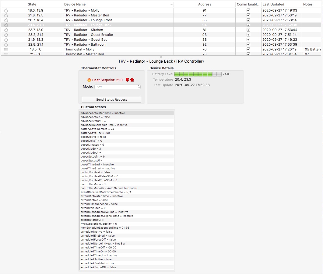

- Indigo - Failed TRVs.jpeg (115.03 KiB) Viewed 6315 times
The other strange things how the TRV controller is working
Shows the Target Temp as 21C and the current Temp is 18.9C and shows Heat as Off?
Why is it ignoring the Temp and not turning on heat?
Totally bizarre

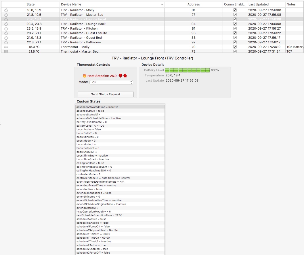

The TRV Controller is showing with BOTH Front and Back as Off while BOTH TRV Controllers show TEMP BELOW TARGET
OK
Now at a state where the TRV Controller is NOT turning on Heat and NOT turning on Radiators.
And appears to have suffered a catastrophic loss of basic math skills.
i.e. in TRV Controller logic 20.3 > 25 therefore DO NOT TURN ON HEAT.
Yes 25 - I have set the target to 25C and completely rebooted computer
and still TRV Controller is declaring 20/3 > 25C
I am at a complete loss as to why the TRVs are failing and the TRV logic is suffering a lobotomy.
TRV Controller see 20.4 > than 25
Fail
Fail
- Multi TRV Controller Failures.jpeg (182.18 KiB) Viewed 6281 times
- Indigo TRV Controller Failure.jpeg (190.57 KiB) Viewed 6282 times

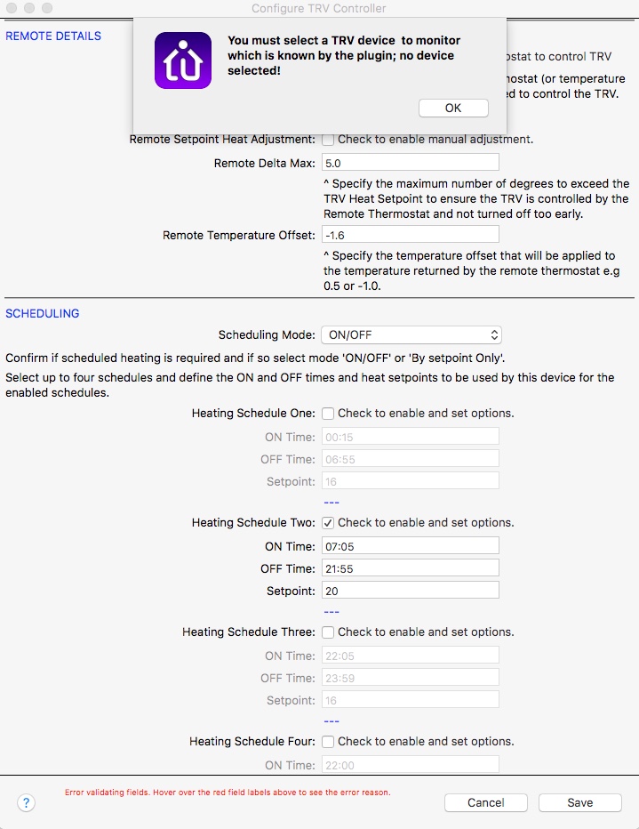

I am seeing that the TRV devices are sometimes taking 30 seconds to open.
and worse you can't save them.... keep getting errors
Related to weird behaviour...
