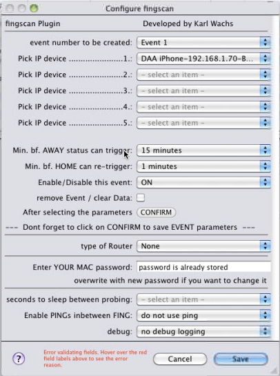

I think this is the correct forum for this. Today I noticed that fingscan seemed to take longer than usual to detect my (or rather my iPhone's) return home, so I checked the fingscan (4.10.25) plugin config and changed the Min bf. HOME can re-trigger: to 1 minute. The default value was five, although I can't remember if I set it to that before, since it used to trigger almost immediately when I arrived home (definitely not five minutes). Anyway, I click CONFIRM and then Save. I get a red message to the left of the Cancel/Save buttons "Error validating fields. Hover over the red field labels above to see the error reason." Except there are no red field labels, and I get the following message in the log:
fingscan Error                  Error in plugin execution UiValidate:
  File "plugin.py", line 719, in validatePrefsConfigUi
<type 'exceptions.ValueError'>: invalid literal for int() with base 10: ''
The only option is to Cancel, and of course the new value isn't saved. It has been working flawlessly (and probably still is) except that I want a quicker return response as before. Any suggestions? TIA
select a value for seconds to sleep ..., the default is 1 but sometimes it shows "select an item.." that translates into a blank and then the conversion to an integer fails.
will post a new version where that exception is caught.
