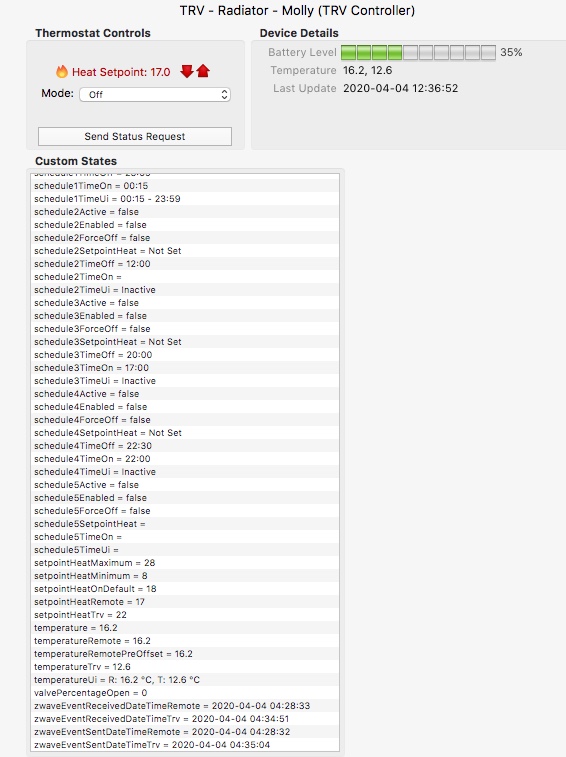

Jon

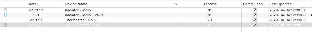

I had three TRVs go rogue today.
The one in Molly's room very interesting....
Despite the thermostat for the room showing 22.3C the TRV Controller is showing the same Thermostat showing 16.2C for a Setpoint of 17c
Once I sent a direct control to the radiator to set set point to 8C and Valve to 0% then the TRV finally caught up.
[img]
Molly TRV Radiator - Rouge TV+RV Controller.jpeg (117.82 KiB) Viewed 6370 times
[img]
[/img]
Molly TRV Radiator - Rouge TRV Controller.jpeg (34.73 KiB) Viewed 6370 times
[/img]
Molly's room was 5.3C over temp.
The Thermostat - zwave Secure - was working and reporting temp correctly
The TRV controller was not reading the external thermostat and keeping both heat demand keeping the control heating on.
I will work on a trigger where the actual Thermostat is different from where the TRV Controller is showing a different remote temp and see how often this is occuring.

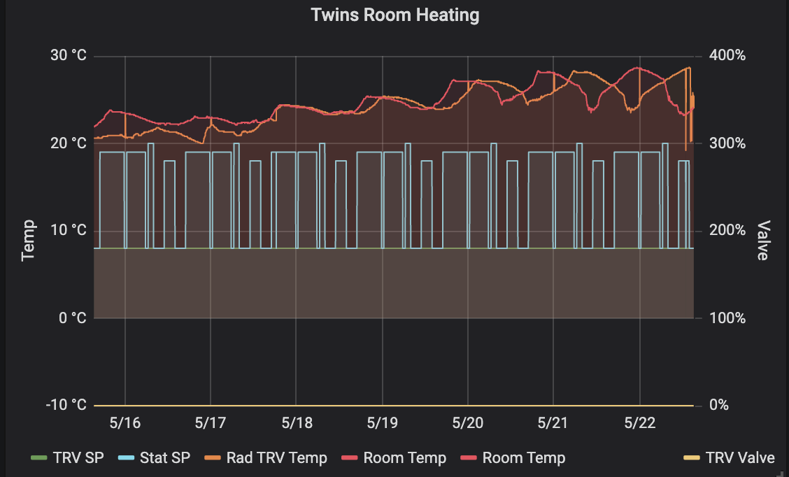

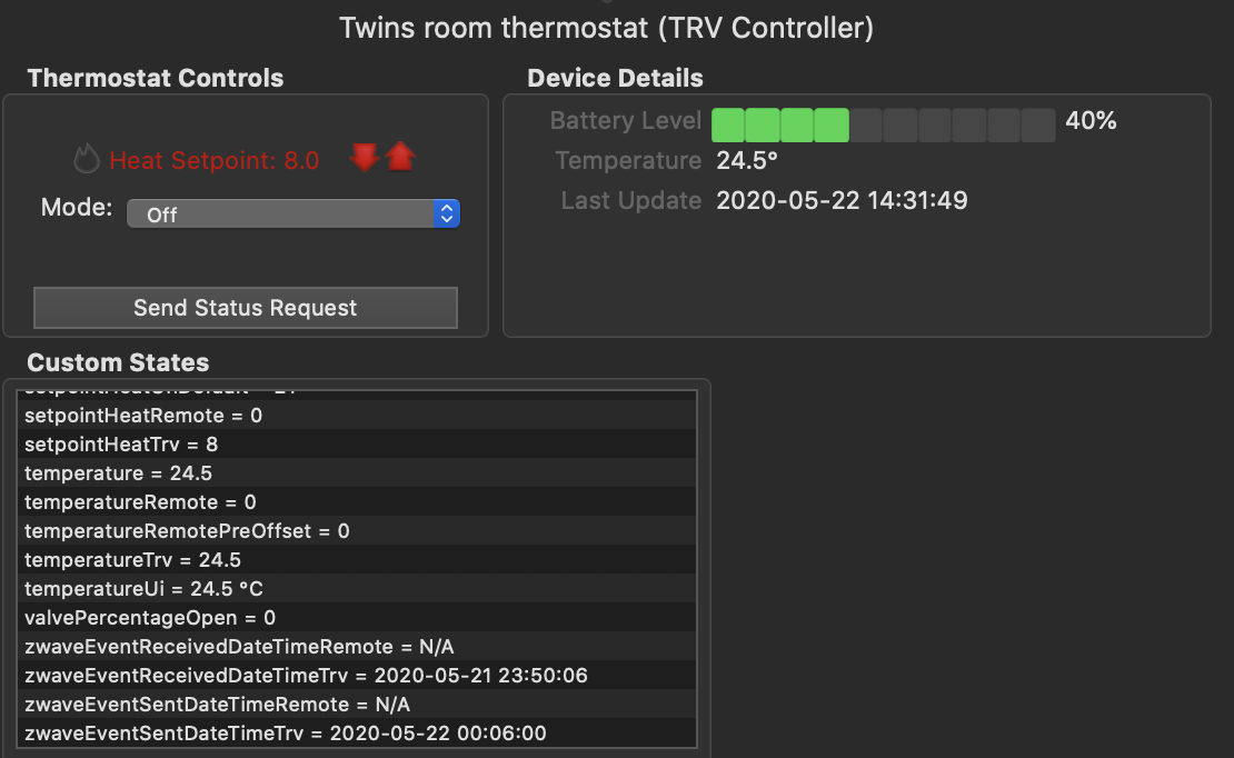

Hi Jon,
I think there is a bug using a pibeacon one wire sensor as the TRV remote control. That device has Temperature as the state, as well as some max and min values.
The current temp on my pibeacon device is 23.5 but with a max of 28.6.
Screenshot 2020-05-22 at 14.30.26.png (32.48 KiB) Viewed 6160 times
The TRV temp is 24.5 degrees at the moment (they are other sides of the room)
Screenshot 2020-05-22 at 14.31.50.png (166.85 KiB) Viewed 6160 times

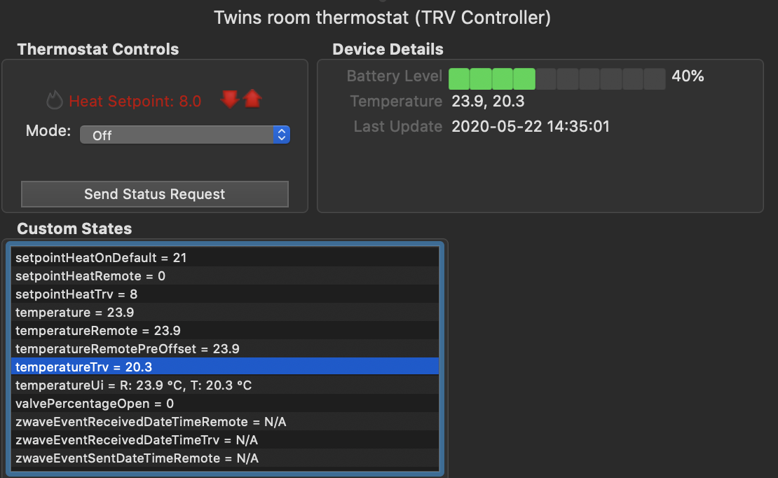

However when I set the TRV controller to use the pibeacon as the TRV remove control, the TRV reports the temperature as>28. Except now I repeat for taking screenshots it has done the opposite, and is showing a TRV temperature of 20.3, I have no idea where its getting that from.
Screenshot 2020-05-22 at 14.35.33.png (167.99 KiB) Viewed 6160 times
In this case, the wrong TRV temperature is not a problem, as the used temp of the remote is correct.
However I was seeing the reported temperature of the TRV controller, ie using the TRV remote of 28 degrees which is clearly wrong.

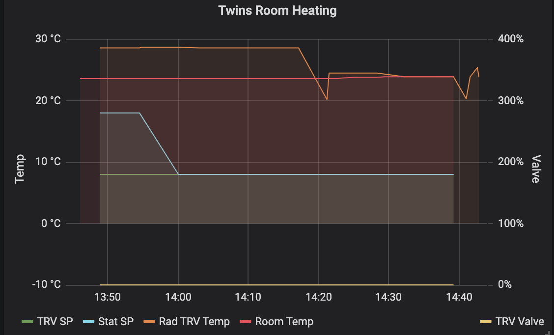

UPDATE - turns out the temperature of the TRV really did drop 4.2 degrees inbetween the snapshots as the window was opened.
I cant get it to replicate the behaviour now but below is my plot of the temperatures.
Orange is the reported TRV controller temp with the pi beacon as TRV remote uo the point it drops from 29 degrees.
Red line is the pibeacon temperature.
At approx 14:18 I stoped it using the TRV remote and it dropped to 20c. When I then put it back to using the TRV remote it reports a temperature almost inline., (exactly after 14:30).
Screenshot 2020-05-22 at 14.45.15.png (76.22 KiB) Viewed 6158 times
Screenshot 2020-05-22 at 15.15.52.png (99.67 KiB) Viewed 6154 times
But then last night, it just seems to start a straight line climb.
Screenshot 2020-05-22 at 15.16.04.png (83.13 KiB) Viewed 6154 times
If I see it happen again, will def get more screenshots of the device.

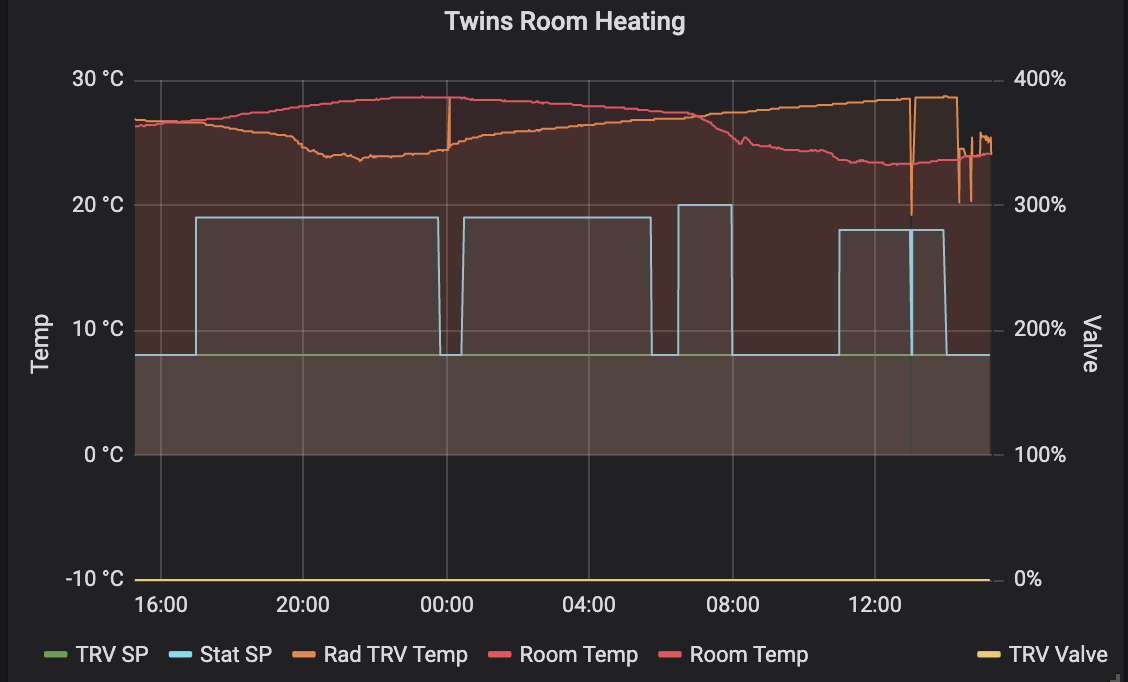

siclark
Posts: 2355
Location: UK
Post by siclark »
Interestingly you can see is spike at midnight to the correct temperature, then drop straight away again.
