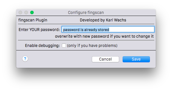

There wasn't a manual when I downloaded it from the forum. This is my "configure" menu panel - all there is is a place to enter a password.
Screenshot 2014-12-11 09.36.46.png (52.07 KiB) Viewed 6806 times
Ok you are using a 1 year old version. Search for fingscan and download. There you find the most recent version.
