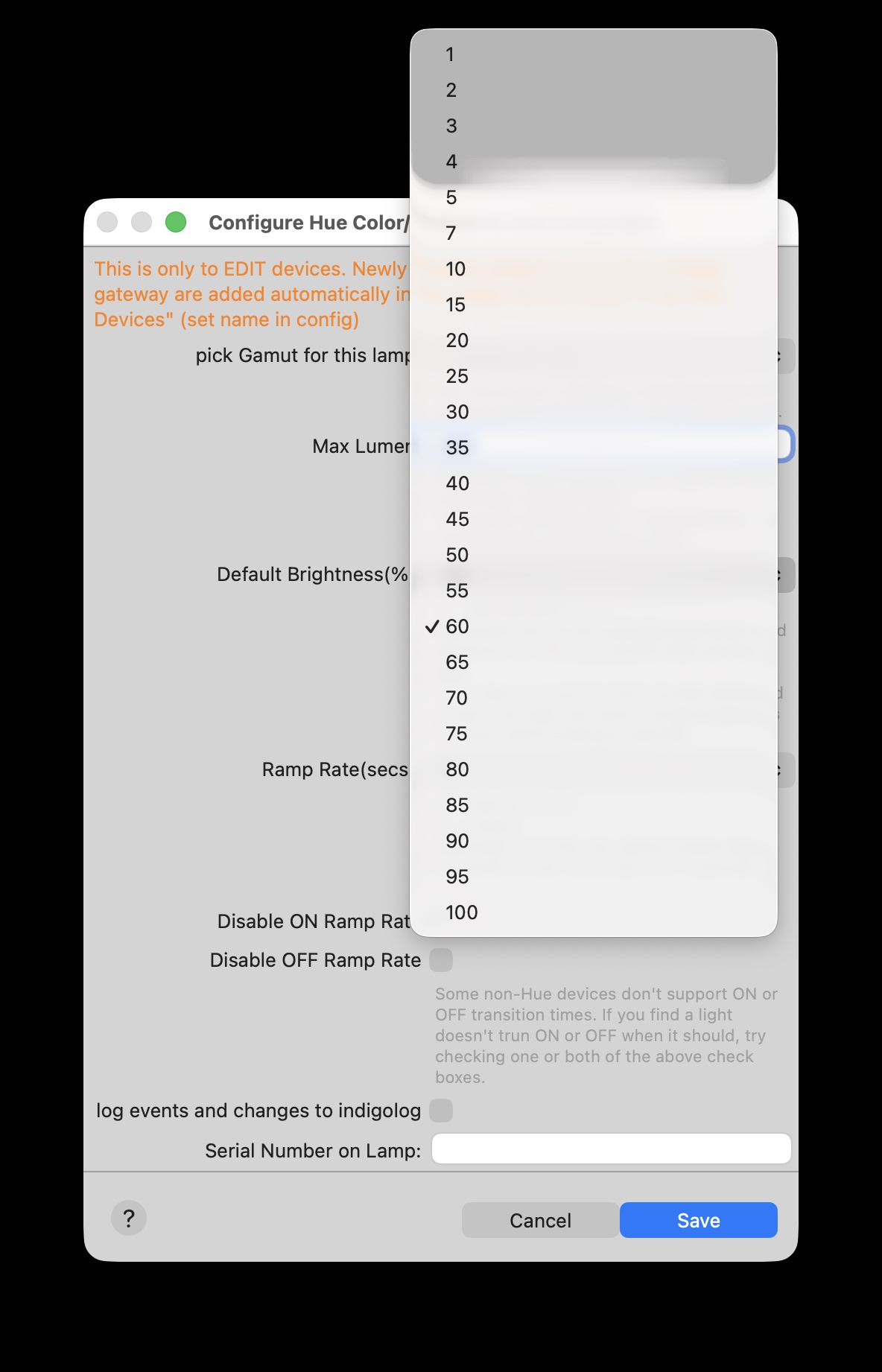

5. added config option to set prefixes for devices names types switch/sensor/light/group eg Hue_light_br#_id#_nameOnBridge (replace light with lampa)

What do I do if I don't want any "default brightness" sent to my Hue lights? I'm looking for a (None) option on the device config. Can you point me in the right direction please?
No Default Brightness Please.jpg (172.18 KiB) Viewed 102 times
Re: Hue new versions
What do you want to do? Just on / off?
SearchCz
Posts: 284
Joined: Wed Sep 18, 2019 4:45 am
Post by SearchCz »
Yes. I am doing an on/off and the device/plugin is reporting this *default* number back as the device brightness initially, then reporting back the actual brightness shortly afterwards. I think I found a workaround for this.
v 2022.33.120
added option to use
- default brightness
- last brightness
to switch on lamps
you can set general pref in config or for each individual lamp in device edit of the lamp
