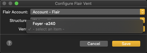

6) Went to add the vents, only one vent is showing up in drop down picker (see screen shot)

Corresponding Debug Log...The plugin gets the list of vents from Flair, but appears the drop down picker is only presenting a single value.

   Flair Debug                     new device: Fetched 1 vent records
Re: New Plugin - Flair Smart Vents
Put the debug log and the data dump (menu command) in this GitHub issue: https://github.com/FlyingDiver/Indigo-Flair/issues/2
