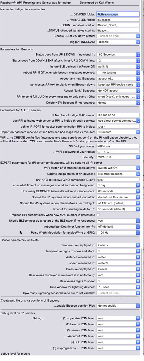

I need the config (screen shot) & RPIconfig(*) file

If you mean "send ALL files and reboot" I clicked that and closed the window but nothing happened.
Here is a sanitized version of the ind.pref file:
and here is the parameters file:
I'll send the screen shot in a little while.

you need to fill out : userid for indigo web server and indigo password (in config)
Although it is not used when you use direct socket comm, but it still checks if the
"passwordOfServer": “xxxx”,
"userIdOfServer": "",
are set.
in config: set comm to indigo web, fill out userid and passwd, and set back to socket comm.
then push all to your rpi.

It was filled in. I just blanked it out when I sent the file to the forum so that info wasn't public.

I just blanked it out in photoshop from the screen shot of the plugin config and in the copy of the file. Not in the original. I agree the pi didn't get the files. When I clicked push all files and reboot, nothing happened.
I will try the commands. I assume I do that from the terminal on the server, not the pi.

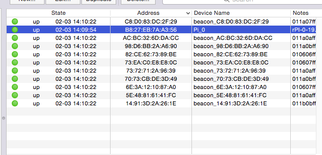

Then I reloaded the plugin, and voila:
- Screen Shot 2019-02-03 at 2.10.51 PM.png (75.96 KiB) Viewed 6254 times
Re: Ir transmitter
Nice to hear.
