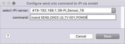

by the way you can do "irsend SEND_ONCE LG_TV KEY_POWER" now with send any unix command action in pibeacon,
Screen Shot 2019-01-27 at 12.03.29.png (23.35 KiB) Viewed 5630 times
but you need to setup all of LIRC.

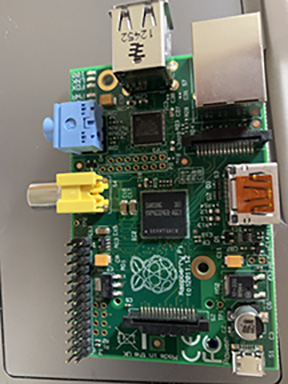

My pi's are fairly old. Maybe even the 1st gen. I've attached a picture.
Should I get a newer model, and if so, what starter kit do you recommend?

as long as it is an RPI 1or higher everything should work fine. ( still have an RPI1 running and it has no hick-ups and everything works fine - actually better that the RPi3 sometimes. )
