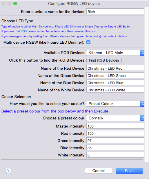

There seems to be something up with using the plugin in action groups.
Here's another one:

  Fibaro Light Manager            Colour of LED StairMood is now Custom
  Fibaro Light Manager Error      Error in plugin execution ExecuteAction:
  File "plugin.py", line 1649, in switchOn
<type 'exceptions.KeyError'>: key colourSelect not found in dict

Chockymonster wrote:There seems to be something up with using the plugin in action groups.
Here's another one:
I'll retest the Action Groups in the morning... but I'm not sure you're using the latest version 0.2.11. Can you check for me?

I still have an issue with my triggers.
I have a trigger, which turns on the LED-Stripe when my ATV1 is playing LiveTV and turns it off when Live-TV is "not true".
See my screenshot, can you find something?
Best,
Yassi
Bildschirmfoto 2015-10-21 um 18.45.35.png (18.17 KiB) Viewed 6061 times

This is caused by the recent updates that I've been doing to allow multiple types of bulbs and led to be controlled by the plugin. Unfortunately, if you have a device that we created before I added this field then Indigo doesn't know about it and claims that it doesn't exist. However, it's easy to fix.
There is a new field on the device. If you edit a device and Edit Device Configuration you'll get a screen like this. You've seen it before except that it now has a new field. This field allows users to add a different type of device than a Fibaro Controller:
New Device Screen
New Device Screen
Screen Shot 2015-10-21 at 18.46.34.png (107.99 KiB) Viewed 6039 times
It's called Multi device RGBW (like Fibaro LED Dimmer) see above. This must be checked to remove the error. If it's already checked I suggest that you uncheck it and recheck it. You could also reselect your preset colour. Then click Save. You'll need to do that with any devices that you created before the last update.
Now your device will have the new field added and the Trigger should work fine :D
If not, and I don't think this is the case, the simplest solution is to delete the device and recreate it (along with your trigger I'm afraid).
I'm fairly confident that the first option will work. Let's me know how it goes. Love the idea of turning the lights on and off when the apple TV comes on - you're a geek just like me :)
Mike

well, I've tried it yesterday (I've disabled an renabled the switch), so far looks good, no errors at all for the moment.
The triggers worked as expected.
I think it's good now.
Thanks a lot for your hint!
