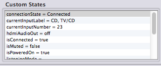

I have been trying to determine the Powered On status and looking at the device status I get the connectionState = Connected, isConnected = true and isPoweredOn = true all the time, even though the receiver is on standby at present thereby no triggers happening!

Coolcaper - I found the issue... it was seeing the receiver as on with any power (including standby) and so I have flipped that to only be "on" if it is at full power. Will have a fix published soon.

Thanks for the update Adam - I can confirm this now reports back the isPoweredOn state properly for a TX-NR616.
