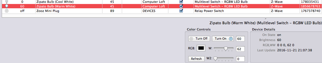

toille27
Posts: 234
Joined: Mon Jul 18, 2011 7:21 pm
Location: Doylestown PA
Re: [SOLVED]: ZIPATO - Bulb LED RGBW Z-Wave
Post by toille27 »
Matt, two tabs appear next to each other in the devices page. I'll send you a sync tomorrow .

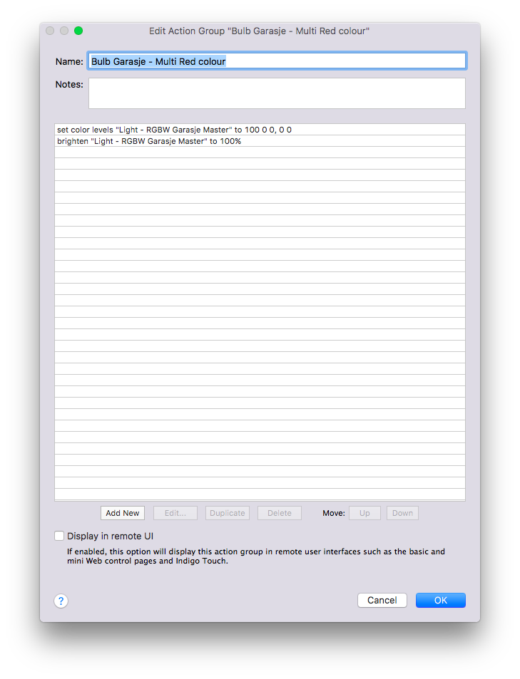

Hi Matt.
I am also seeing the same behavior and UI.
To get this to work "properly" I have been tweaking this with action groups as long as I have used this device.. Always sending an off command before setting the rgb value, en brightness at the end. I spent quite some time trying to figure out how get it to work "ok". Below is my sync log.

What I think is complicating things here is that there are 2 different firmware versions with very different behaviors. There is the older version (module app version 1.05) which defines 2 different end points (personalities) for the device, and there is the newer version (module app version 1.06 and higher) that defines just a single device.
I'm not sure how the Indigo 7 changes are working with 1.06 yet. I know forum user opbzil has that one, but I think most others (haavarda, krissh, toille27) probably have the older more "eccentric" version.
For the older firmware I believe the 2nd device controls the brightness of white, and the color temperature of the white should be set via the Color Temperature edit field in the settings dialog. The first device should be used to set only the RGB components. I don't think you want to try to use the W or W2 sliders at all with the older firmware. I might try to get those hidden/disabled, but it is somewhat problematic since the device definition is shared with the newer firmware version.
For the newer firmware there will be just a single device and hopefully all the UI will work correctly.
It sounds like in the older firmware the module is getting confused if one of the devices is controlled without the other one being turned off? Also just leave those W and W2 sliders at 0, I think.

I am a little uncertain on how to do fault finding on this. If I try to change colour on the device UI it is working. But if I try to do it with an action group it does not change colour.
I dont know if the info below helps. Please let me know if you need any other data. I have tried to re include the device since I at one time thought it had gotten in to a bad state.

And now the colour change from Action group:
   Action Group                    Bulb Garasje - Multi Blue colour
   Schedule                        _delayed_action_90
   Z-Wave Debug                    SENT setRgbColorValues: 01 14 00 13 78 0D 33 05 05 02 00 03 00 04 FF 00 00 01 00 25 18 78
   Z-Wave                          sent "Light - RGBW Garasje Master" set color to 0 0 100, 0 0
   Action Group                    Bulb Garasje - Multi Green colour
   Z-Wave Debug                    SENT setMultiLevelValue: 01 0A 00 13 78 03 26 01 63 25 19 E5
   Z-Wave                          sent "Light - RGBW Garasje Master" set brightness to 100
   Schedule                        _delayed_action_89
   Z-Wave Debug                    SENT setRgbColorValues: 01 14 00 13 78 0D 33 05 05 02 00 03 FF 04 00 00 00 01 00 25 1A 7A
   Z-Wave                          sent "Light - RGBW Garasje Master" set color to 0 100 0, 0 0
   Action Group                    Bulb Garasje - Multi Red colour
   Z-Wave Debug                    SENT setRgbColorValues: 01 14 00 13 78 0D 33 05 05 02 FF 03 00 04 00 00 00 01 00 25 1B 7B
   Z-Wave                          sent "Light - RGBW Garasje Master" set color to 100 0 0, 0 0
   Z-Wave Debug                    SENT setMultiLevelValue: 01 0A 00 13 78 03 26 01 63 25 1C E0
   Z-Wave Debug                    SENT setRgbColorValues: 01 14 00 13 78 0D 33 05 05 02 00 03 00 04 FF 00 00 01 00 25 1D 7D
   Z-Wave Debug                    SENT setMultiLevelValue: 01 0A 00 13 78 03 26 01 63 25 1E E2
   Z-Wave Debug                    SENT setRgbColorValues: 01 14 00 13 78 0D 33 05 05 02 00 03 FF 04 00 00 00 01 00 25 1F 7F
   Z-Wave Debug                    SENT setRgbColorValues: 01 14 00 13 78 0D 33 05 05 02 FF 03 00 04 00 00 00 01 00 25 20 40
   Z-Wave Debug                    SENT setMultiLevelValue: 01 0A 00 13 78 03 26 01 63 25 21 DD
Skjermbilde 2017-03-21 kl. 18.08.14.png (78.02 KiB) Viewed 4084 times
Håvard
krissh
Posts: 105
Joined: Sun Nov 18, 2012 6:59 pm
Location: Norway
Post by krissh »
I was able to sort of use it reliably with Indigo 6, but after spending many hours trying to get it to work with 7, I gave up and bought an Aeotec bulb.
haavarda
Posts: 702
Location: Norway
Post by haavarda »
Matt, did you get out of my Event Log snippets?
Håvard
matt (support)
Posts: 21542
Location: Texas
Post by matt (support) »
Yes, I'll be investigating this more shortly.
