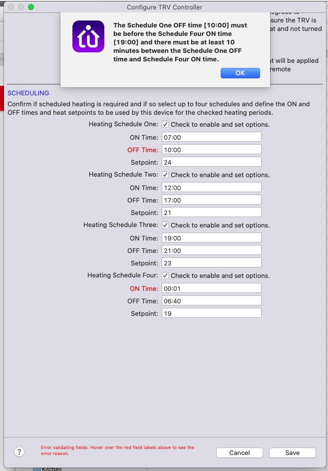

Some questions to the validation process )
What's wrong here?

shapa wrote:Some questions to the validation process )
What's wrong here?
More or less what the error message says. :wink:
The schedules have to be in time order.
Also, make the first schedule start at (I suggest) 00:15 (not 00:01) as all the schedules get reset at 00:05 to make sure that the schedule timers are re-instated. :)

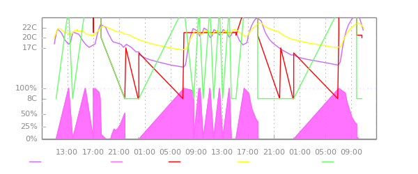

Autolog - just a heads up of a weird issue that has come up twice in 24 hrs.
I have changed the set point for the Day schedule to 20.5 for the Lounge Front and Back TRVs.
The Back TRV reported the Remote Temp (SRT321) as 23.5C and the set point as 25.5C.
And driving the central heating hard to get the Lounge to 25.5C.
Restarting the TRV Plugin reset the Lounge Back to 20.5C SetPoint and immediately turned off heating.
This occurred yesterday afternoon when I changed the SetPoint to 20.5 and again this morning when the Day Schedule started.
Both TRVs are Spirits. Front .15 and Back .16 firmware (maybe significant ?)
Indigo 7.4 TRV Plugin 1.3.1 on Mac OS 10.12.6
I have now set both Front and Back to 20C for Day Schedule - and will keep a closer eye on it.
Maybe significant - Over the weekend despite the Back TRV reporting valve open 100% and Remote Temp Below Setpoint and the Front TRV was Open and radiator hot the Back radiator was cold. Obviously the valve was actually shut. The battery was reporting 35% but just in case I swapped out the batteries and the valve opened and the radiator got hot immediately.
It maybe unrelated, it maybe a faulty Spirit. I'll keep a better eye on it.
Chart - Radiator - Lounge Back.png (52.75 KiB) Viewed 3873 times
I'll report back with more details if it occurs again.

When you reload the plugin it will set the schedules back to the plugin default as defined for each TRV Controller device. Did you rerun the action to set the Day Schedules again?
Busta999 wrote:Maybe significant - Over the weekend despite the Back TRV reporting valve open 100% and Remote Temp Below Setpoint and the Front TRV was Open and radiator hot the Back radiator was cold. Obviously the valve was actually shut. The battery was reporting 35% but just in case I swapped out the batteries and the valve opened and the radiator got hot immediately.
Yes I have seen this - I think it possibly is a firmware bug. I am thinking about how I could easily detect this. :?
I have been doing a few changes to support a revised scheduling mode (just setting times and set points). It is work in progress. It was getting a bit difficult / time consuming doing enhancements/corrections to the existing version (1.3. series) and keeping version 1.4 up-to-date with those changes.
Having the TRV On/Off setting enabled may help. However, I have discovered a potential problem with the TRV ON/OFF processing and have enhanced/corrected this in version 1.4. So as long as you don't attempt to use the new scheduling mode as it doesn't work yet - it may be worth trying this new version.
I think what I will do is put in pre-release version 1.4 up as a pre-release on Github. I can then just work on one code version to do the other enhancements/corrections that have been asked for. :)
Nope just as Plugin Reload.
TRV On/off was enabled
I'll keep an eye open on Github for when you post 1.4 and give it try.

The problem was
Whilst in normal running the TRV changed the set point to 5c above the target in the schedule, ie targeted at 20.5 but had an actual set point of 25.5c while the remote temp sensor was reporting 23.5c.
The TRV was keeping the heating on so the lounge was getting very hot
To fix the immediate problem I reloaded the TRV plugin.
That restored the TRV to the correct set point and accordingly shut down the heating.
Hopefully explained it better ?

Yes, I understand now and that obviously isn't correct. :(
If it happens again, let me know and I will dig deeper. May need you to turn on debug logging. :)
