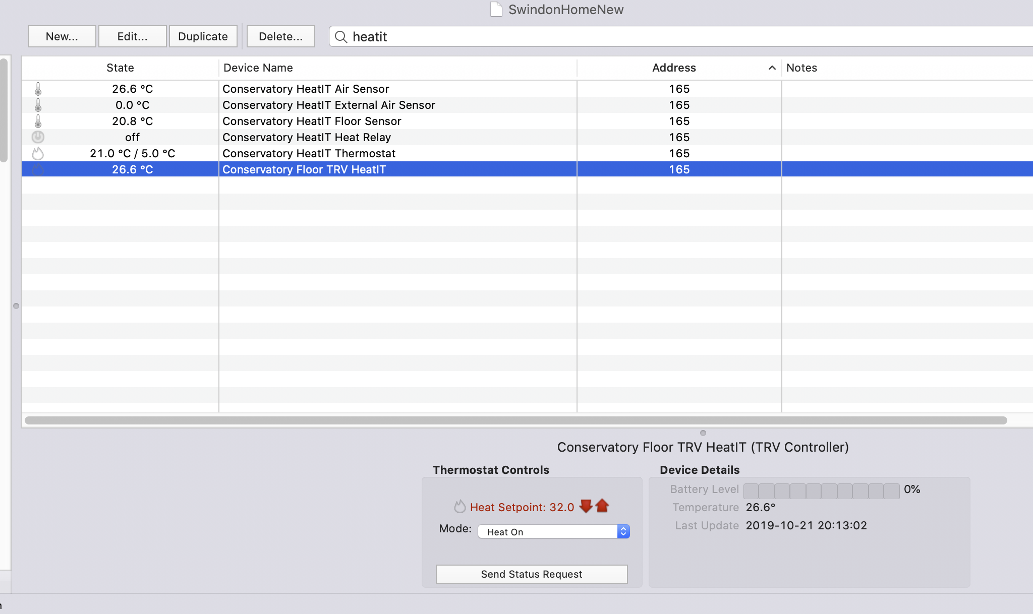

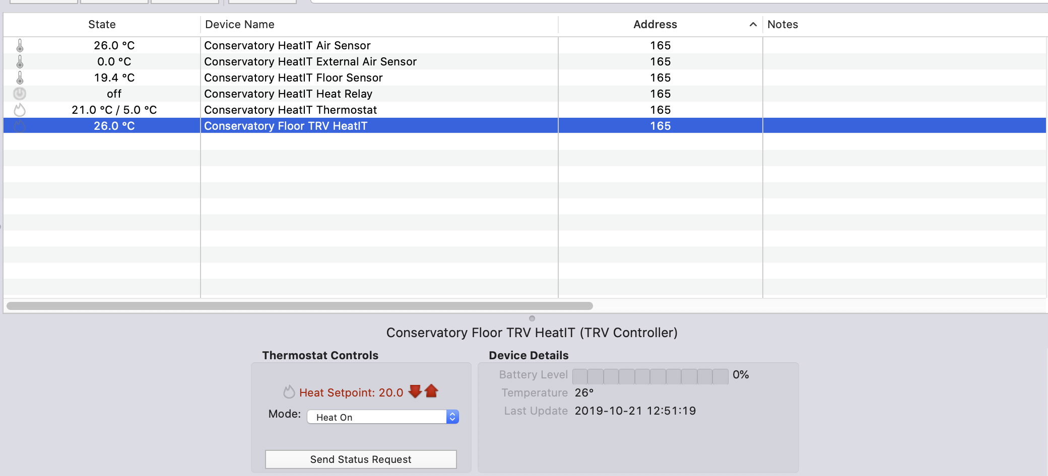

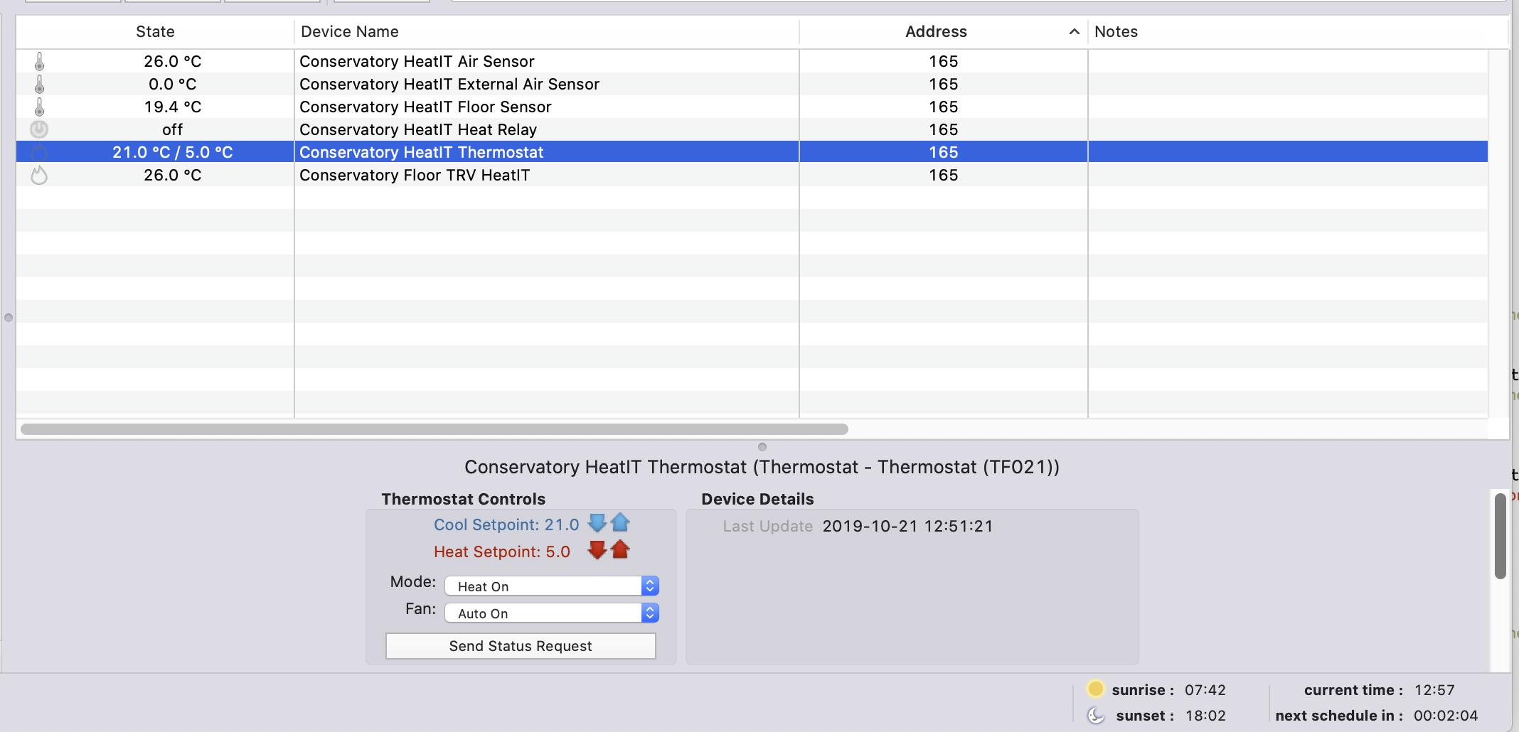

Actually, tried everything, including TRV device delete and create.
1) Physical device (physical buttons) - resetting back to 5C in a few seconds ( Z-Wave sent "Conservatory HeatIT Thermostat" change heat setpoint to 5.0°)
2) Physical device via Indigo UI - resetting back to 5C in a few seconds ( Z-Wave sent "Conservatory HeatIT Thermostat" change heat setpoint to 5.0°)
3) TRV device - adjusting the temperature but physical device is not syncing / staying at 5C
Only happens when the "remote stat" is specified.

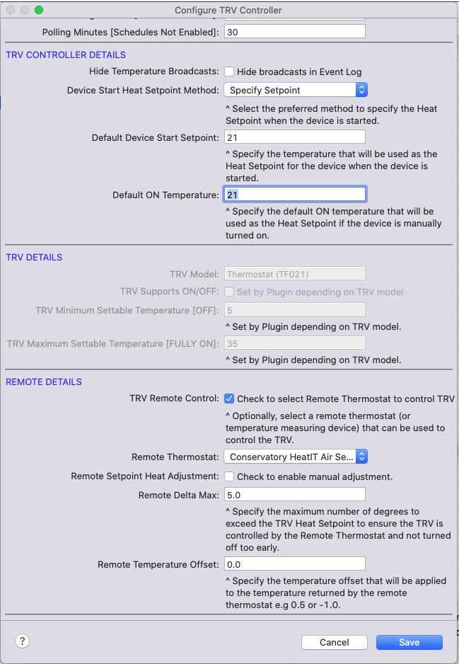

Have you got Remote Setpoint Heat Adjustment enabled in the TRV Controller device settings?
What are you setting the setpoint to?
No adjustment enabled
Any setpoint - tried 19, 20, 25, etc... Identical outcome - resetting back to 5C

In the previous image your Air sensor (which is the remote stat?) is showing 26 deg C which I think is why it is setting the temp to 5 deg C i.e. effectively off.
It is more than 21 deg C. Is the 26 deg C correct?

Tried to set 32C - the same issue, resetting to 5C
