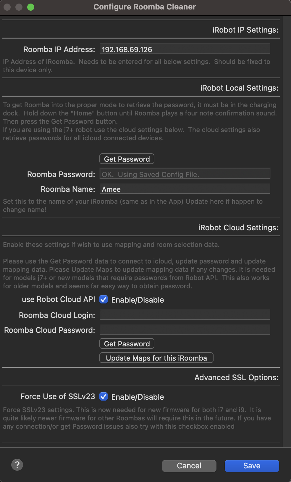

I'm having an issue ading my Roomba i7+ to the plugin.I was able to get the local password but I haven't been able to get the cloud configuration to work. Maybe I'm missing something in the process. It wan't clear if you need to do both the local "Get Password" and the Cloud sections or just the cloud section for the i7. I tried both the with and without the forced SSL setting.
Here's the error from the log
I checked the git site and the plugin page but neither have the updated configuration menu. My i7 only gives a two note tone when holding down the home button and then the circle indicator is blue. It's in another room so it takes 10 seconds or so to get back to my Mac to click the "Get Password" button. Any suggestions to try next?
iRobot-Roomba File should equal:/Library/Application Support/Perceptive Automation/Indigo 2023.1/Preferences/Plugins/com.GlennNZ.indigoplugin.irobot/192.168.69.126-config.ini
iRobot-Roomba Sending discovery to any iRoombas on network... Please wait...
iRobot-Roomba Getting Roomba information from iRobot aws cloud...
iRobot-Roomba Error Caught Exception:'sessionInfo'
File "plugin.py", line 709, in threadgetPassword
result = password(self, address=roombaIP, file=filename, useCloud=useCloud, cloudLogin=cloudLogin, cloudPassword=cloudPassword, forceSSL=forceSSL)
File "/Library/Application Support/Perceptive Automation/Indigo 2023.1/Plugins/iRobot-Roomba.indigoPlugin/Contents/Server Plugin/roomba.py", line 156, in __init__
self.get_password(address)
File "/Library/Application Support/Perceptive Automation/Indigo 2023.1/Plugins/iRobot-Roomba.indigoPlugin/Contents/Server Plugin/roomba.py", line 250, in get_password
iRobot.login()
File "/Library/Application Support/Perceptive Automation/Indigo 2023.1/Plugins/iRobot-Roomba.indigoPlugin/Contents/Server Plugin/getcloudpassword.py", line 128, in login
"oauth_token": response['sessionInfo']['sessionToken'],
KeyError: 'sessionInfo'- Attachments
- Screenshot 2024-01-15 at 11.13.02 AM.png (287.19 KiB) Viewed 1791 times

Hi
The timing of pushing button is very tight. 10 seconds is probably to long - I do it via a ipad remoted into the indigo Mac.
But essentially the annoyance of local password getting which everyone finds (across a lot of implementations) is what lead to the icloud password.
My advice is just use that - typically what I do now when needed. Only need one or another not both.
Can get the password via icloud -it’s saved locally in file, and then if wish can remove password info from dialogues (is only used when button is pressed)
Glenn
Glenn

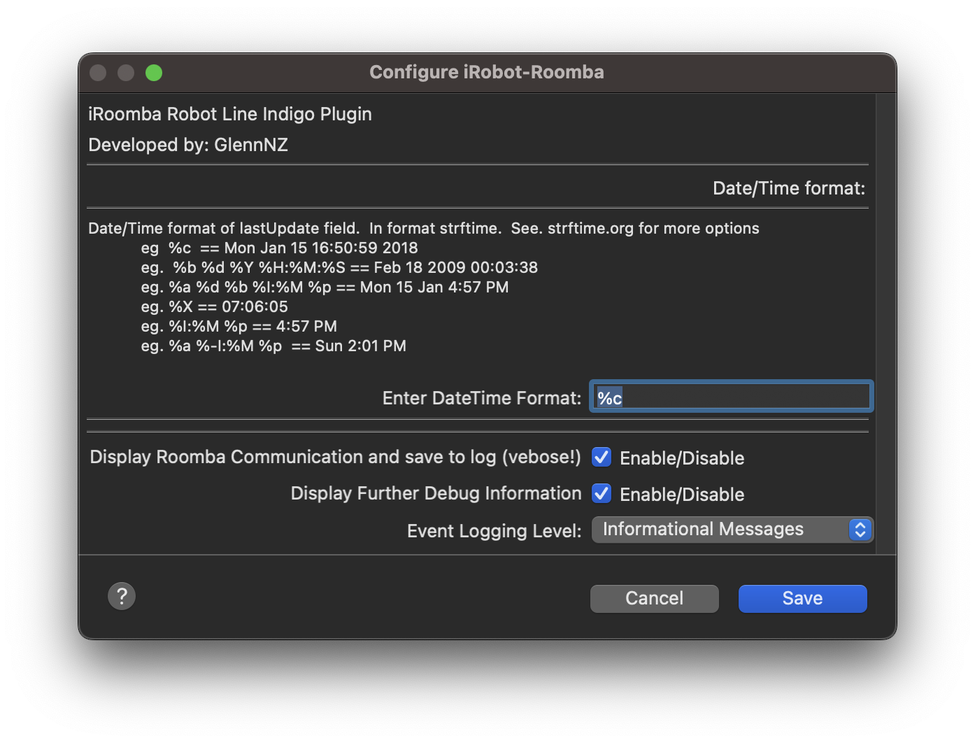

Re: iRoomba iRobot Plugin
I tried using a VNC client on my iphone but that didn't make any difference. I get the same error.
I also noticed the plugin screen on my 0.9.20, from the plugin store, doesn't have all the fields as the one in the docs and forum pages. Is there something wrong with my install?
iRobot.login()
- Screenshot 2024-01-15 at 6.37.39 PM.png (387.63 KiB) Viewed 1768 times
Hi
What are you comparing to? would seem unlikely related, as you have installed 0.9.20 - which is latest version.
When use the Cloud get password - don't need to press any buttons on local iroomba. Checks iCloud for saved roombas - matches to iroomba you have selected and saves password for local use.
The getpassword using iroomba cloud is failing for some reason.
If you enable debug logging in plugin config might let us know why
Otherwise would check username, password is correct
Should I put fill in the "Roomba Cloud Login" and "Roomba Cloud Password" or will both of those be filled by the "iRobot Cloud Settings -> Get Password" like the local Get Password?
This is an i7 Roomba. What I want to be able to do turn on lights when it starts up and turn them off when its done. I plan to use the iRobot app to set cleaning schedules. Is the cloud config necessary or appropriate for this model and task?
Here's the debug with both of those fields empty.

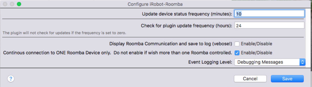

iRobot-Roomba Debug validatePrefsConfigUi calledRe: iRoomba iRobot Plugin
Regard the menu being different
Here is the one from the plugin page and what I think is the same page on mine that is missing a couple config fields
How do I change the devices update frequency or did you decide that is not necessary and removed it?
- Screenshot 2024-01-15 at 6.37.39 PM.png (387.63 KiB) Viewed 1688 times
- iRobot Plugin-Config .png (78.71 KiB) Viewed 1688 times
