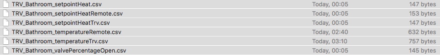

Any TRV Device Settings to make the recording of TRV readings to CSV more timely?
I suspect I am doing something obvious and wrong here..... any pointers much appreciated.
Specifically the "TRV_Bathroom_setpointHeatRemote.csv" which I am trying to use for Graphing in MatPlotLib.
The Zwave Thermostat sensors are reliably getting readings back to Indigo every 10 mins OK.
But the "TRV_Bathroom_setpointHeatRemote.csv" may go 11 hours or more with updating with the temp readings.
I can work around this easily by tracking the zwave sensors directly in MatPlotLib - but trying to keep the work level down on the Mac by cutting down the (large) number of things I already have MatPlotLib do.
Here is a snapshot taken at 11:53 am today of one TRV CSV files
Indigo - TRV - CSV creation.jpeg (38.89 KiB) Viewed 2826 times
The other 7 TRVs have similar issues.

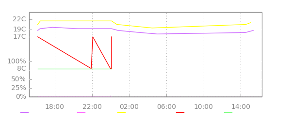

So using data exclusively from the TRV CSV files you get this graph...
Chart - Radiator - Bathroom.png (19.75 KiB) Viewed 2799 times
Just trying to get my head around the Plugin.
So by my reckoning from that graph, the TRV Temp Sensor (Thermostat on Graph) and Remote Sensor (Actual temp) are getting readings consistently and ..
No Valve activity (correct as room temp did not fall below SetPoint)
The SetPoint (TRV_Bathroom_setpointHeat) is set to 17C consistently.
The SetPoint is dipping to 8C as part of the TRV Controller activity -
Last report was 12:05am
@AUTOLOG Anyway that could be avoided i.e. to extend battery life?
(TRV_Bathroom_setpointHeatTrv) stays consistently at 8C and last report was 12:06am
As an extra - using Enloop hybrid rechargeables they have been in since 22 June and still showing 45% battery left, as I recall it was showing 80% when I first put them in. That was during a British summer which was abnormally hot this year.
Testing Amazon own brand rechargeables next.

Probably not without some changes to the TRV code. :|
Your graph line for the setpoint would give a better indication if you set the Line Style to Steps Post - not that this would change what you are asking for.
I think the answer is to change the way the schedules are done and get rid of On and OFF periods and just have times and Required Setpoint.
I will try and have a look at this but not sure how much time it will take or how soon I can get round to looking at it. :)
