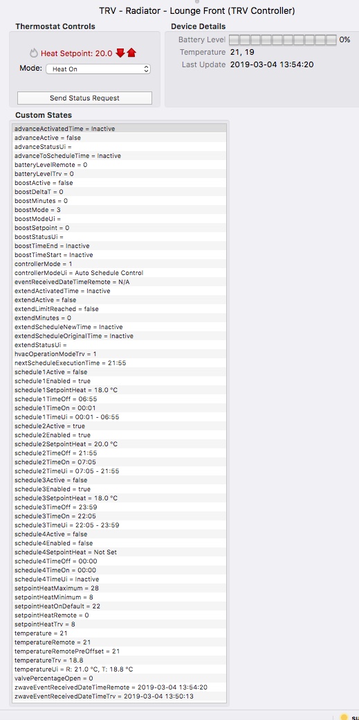

Any reason for the discrepancies between front and read Spirit TRVs when they are running form the same settings and same external Temp Sensor?
Lounge Front Batteries dropped from 15% - 0% at midnight last night.
Disregard Battery level in Lounge Front - put new batteries in this morning - just not reflected yet.
Not an issue - just curious as to differences.
Front is on fw .15 and Rear is on .16 - that may be the difference ....?
A curiosity rather than an issue.

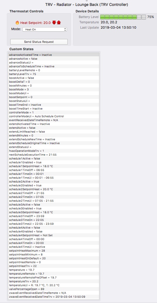

It appears something odd was happening with the remote Temp Sensor or more precisely the TRV's reading goof the temp.
Both Lounge Front and Rear use the Temp: Lounge (CalibratedZW) Temp sensor a Z Wave Multi Sensor 6.
One TRV was showing the external Temp Sensor as 20.0 and. the other as 20.9 - both reading the same sensor and getting different readings even though they were reading within 4 seconds of each other.
I set the incorrect one to use a different sensor - saved it, then set it back to the correct one and it refreshed with the correct reading.
I'll keep a closer eye on both radiators and see if the discrepancy occurs again.

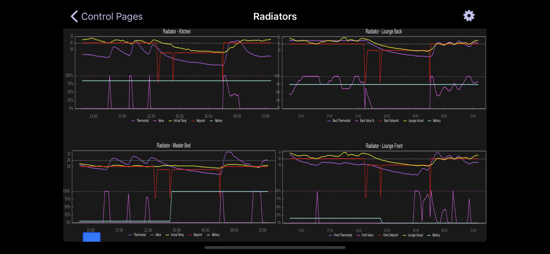

As an aside: Have you investigated the CSV creation that the TRV Controller plugin can do for you. It is effectively done on demand (via an action, normally invoked from a Control Page). I added this to the plugin as it is much more efficient in computer usage as the CSV file is only updated when its output is being viewed.
Had you applied an offset to one and not the other?Busta999 wrote:It appears something odd was happening with the remote Temp Sensor or more precisely the TRV's reading goof the temp.
No both are identical - finally worked out how to get the offset in the sensor _ the best place for an offset - I had been struggling to get the offset right - but was helped elsewhereautolog wrote:Had you applied an offset to one and not the other?Busta999 wrote:It appears something odd was happening with the remote Temp Sensor or more precisely the TRV's reading goof the temp.
No - somewhat daunted byAs an aside: Have you investigated the CSV creation that the TRV Controller plugin can do for you. It is effectively done on demand (via an action, normally invoked from a Control Page). I added this to the plugin as it is much more efficient in computer usage as the CSV file is only updated when its output is being viewed.
I am also using MatPlotLib to generate the graphs from the CSV data that the plugin creates.Busta999 wrote: .... No - somewhat daunted byI should do - I am really enjoying the MatPlotLib graphs right now - but should use your way as more efficient
When I invoke the Control Page that has the graphs, the related server actions (on the page where I select the graph Control page) are: 1) run the TRV Controller plugin action to create the CSV files and then create the graph (via a MatPlotLib action) with a delay of 3 seconds to allow the CSV files to be created. On the Control Page that displays the graph, tapping or clicking on the graph runs the two same actions to recreate the graph.
I normally display 24 hour graphs but have added buttons beneath the graph for 12 hours, 6 hours and 3 hours. Clicking on any of those buttons will regenerate the CSV file and Graphs using the aforementioned actions. The CSV creation Action allows you to specify the period.
In the case of CSV creation using PostgreSQL, the values in the CSV file are taken directly from the Indigo Log and therefore you only get an entry when something changes. The CSV file is top and tailed so that all graph lines start at the Left of the x-axis and end at Right of the x-axis.

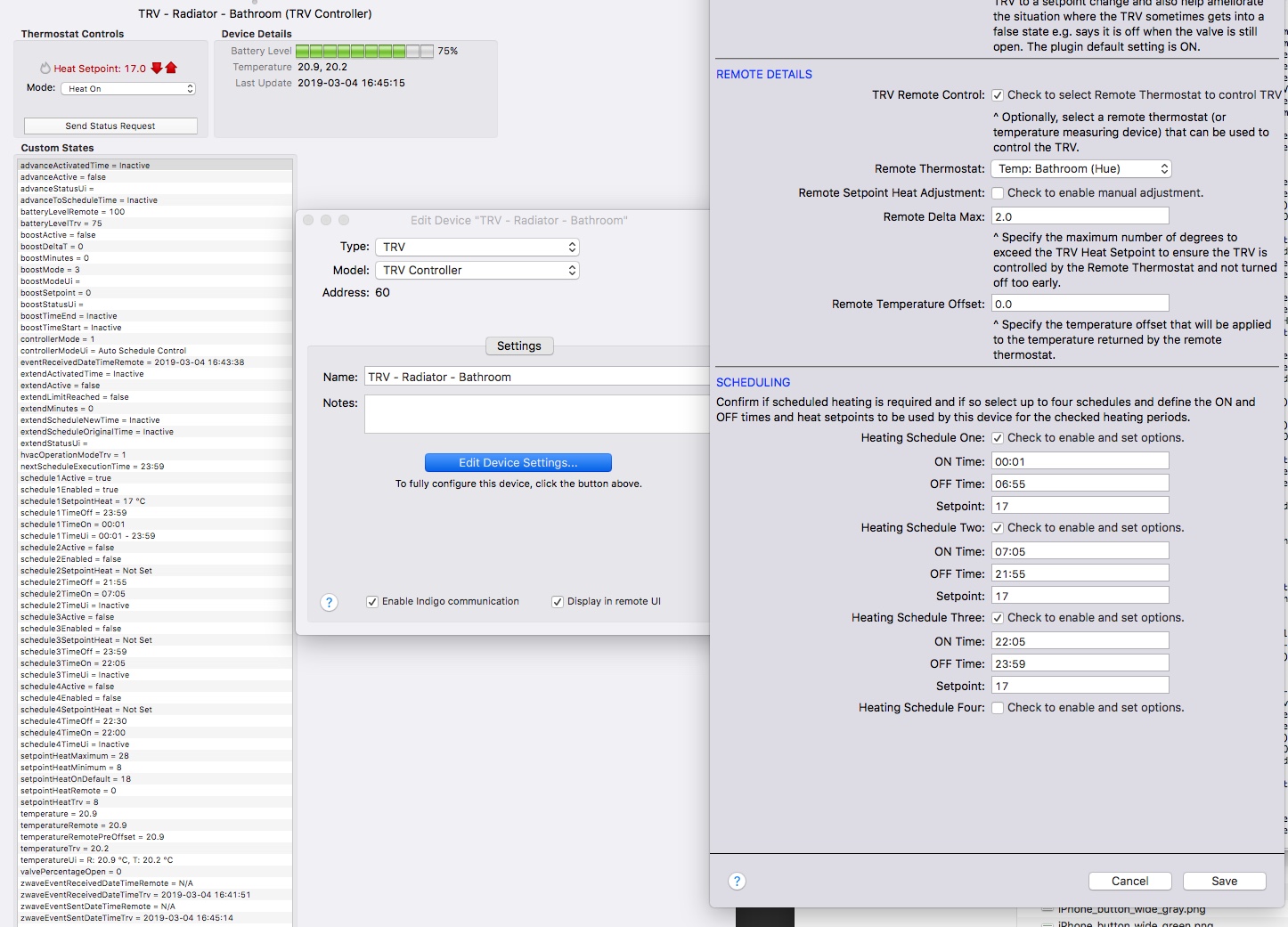

Ok I think I have found a really odd one...
I have set up an action group to shut off the unused Guest rooms/bathrooms/ensuites - and to set the TRVs to 17.
Then created another action to setup the rooms and restore to a three schedule day of varying temps throughout the day.
The Off is working as expected - in the TRV properties you an see one schedule 00:001 - 23:59 - 17C great.
if you open the TRV up Scheduling still shows old three schedules.
Is it possible the TRV Config is not re-reading in its settings?
If Device start heat set point method is - Specifiy Setpoint
Also if I disabled all Schedules would it go to Default Device Start set point or Default ON Temperature settings?
Run an Action Show Schedule for the device - what does that show? Post the output so I can see.Busta999 wrote:Ok I think I have found a really odd one...
It will (should) go to the default start setpoint if schedules are disabled.
TRV
== TRV Controller Plugin - Heating Schedule ==
== Device: 'TRV - Radiator - Bathroom' ==
== Schedule Type: 'Default' ==
== Schedule 1: 00:01 - 06:55. Setpoint = 17.0 ==
== Schedule 2: Disabled ==
== Schedule 3: Disabled ==
== Schedule Type: 'Running' ==
== Schedule 1: 00:01 - 23:59. Setpoint = 17.0 [*] ==
== Schedule Type: 'Dynamic' ==
== Schedule 1: 00:01 - 23:59. Setpoint = 17.0 ACTIVE ==
[attachment=0]TRV - Actual and Config.jpeg[/attachment]
- TRV - Actual and Config.jpeg (393.35 KiB) Viewed 2923 times
I think it is (mainly) OK
When you run an Action to setup a revised schedule, it doesn't alter the device definition which is the default.
However, the Show Schedule looks as though it isn't 100% correct as it should be listing out the device default schedule and it doesn't appear to be doing so,
I will take a look at it.
The custom states seem to show that the updated schedule is setup OK i.e. only schedule 1 active and on at 00:01 and off at 23:59.
If you override the default schedule using an Action, this has to be run on a daily basis (say at 00:15) as everything is reset at 5 minutes past midnight.
