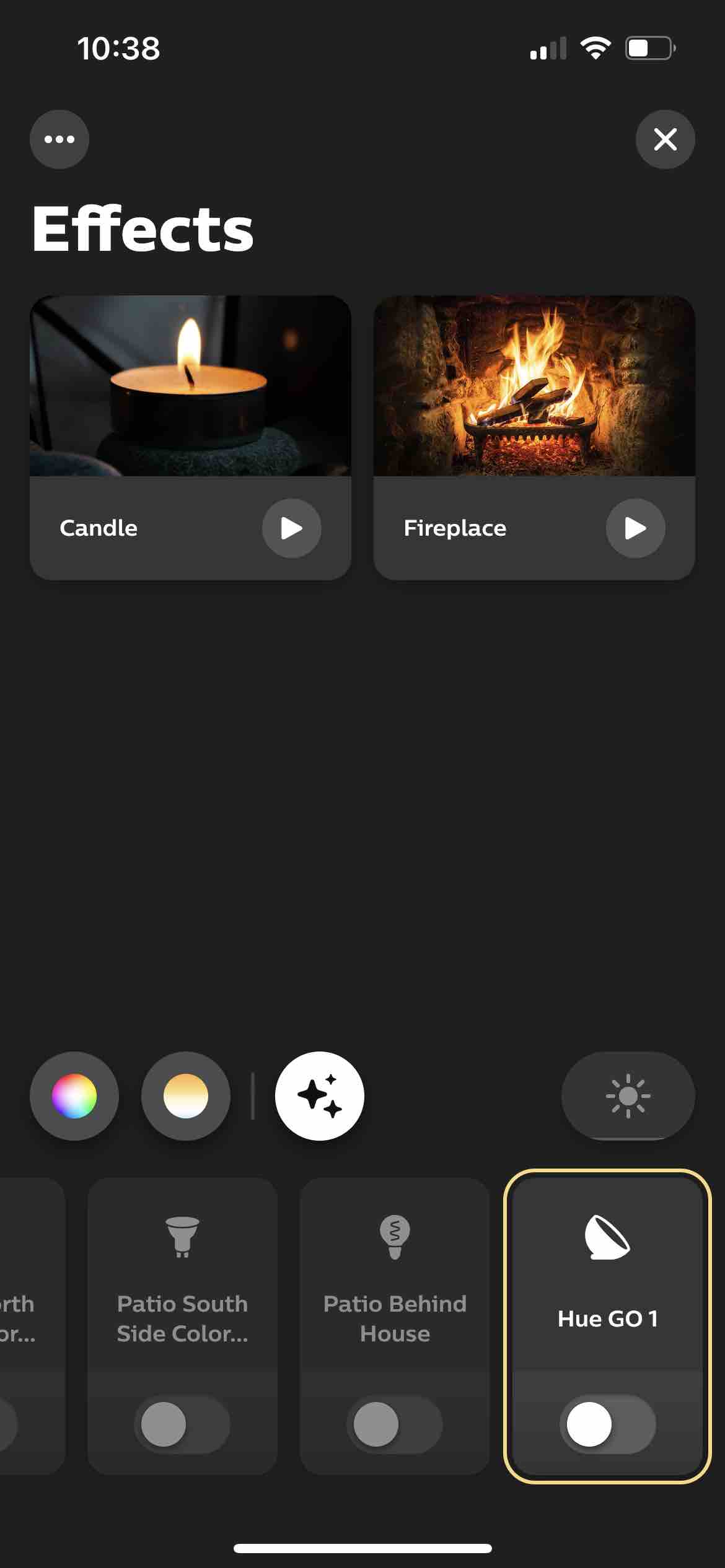

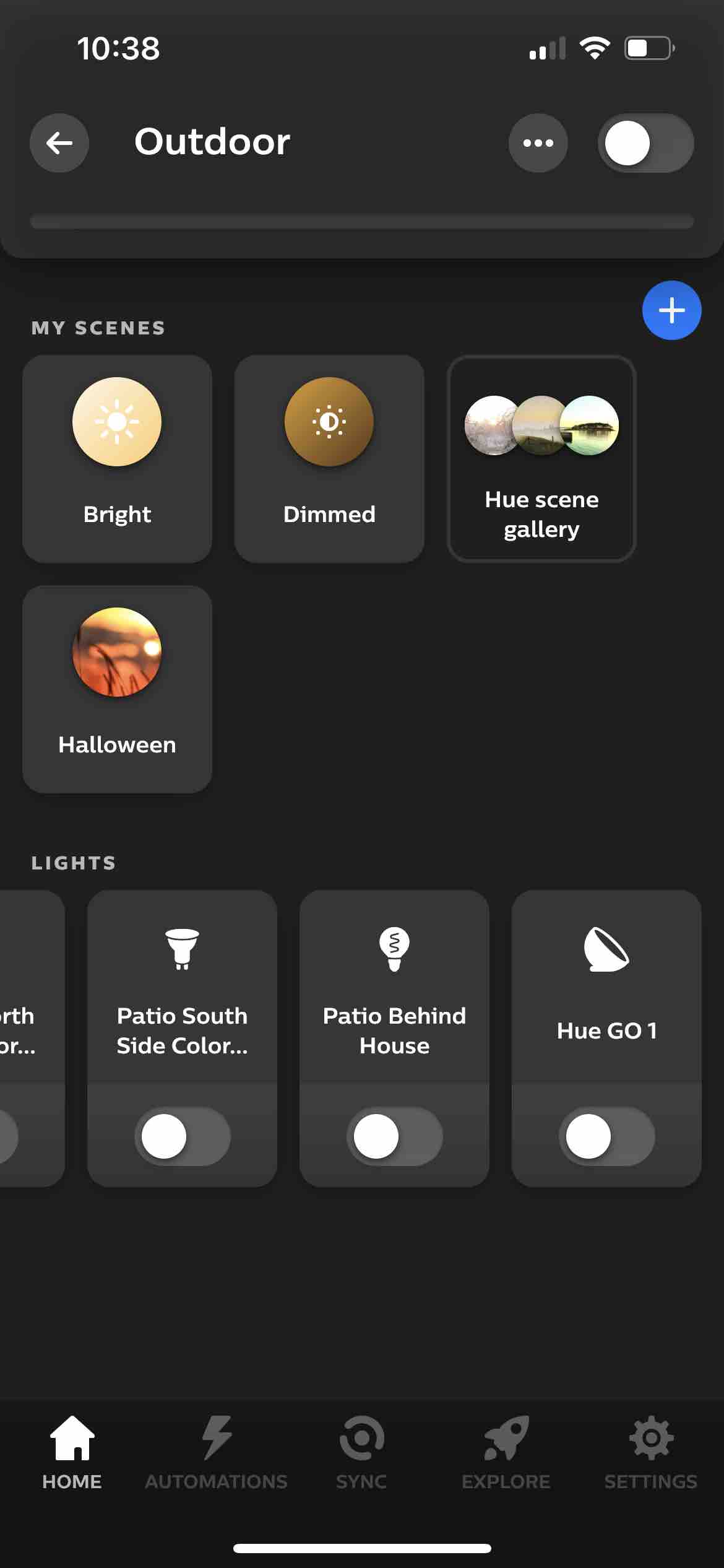

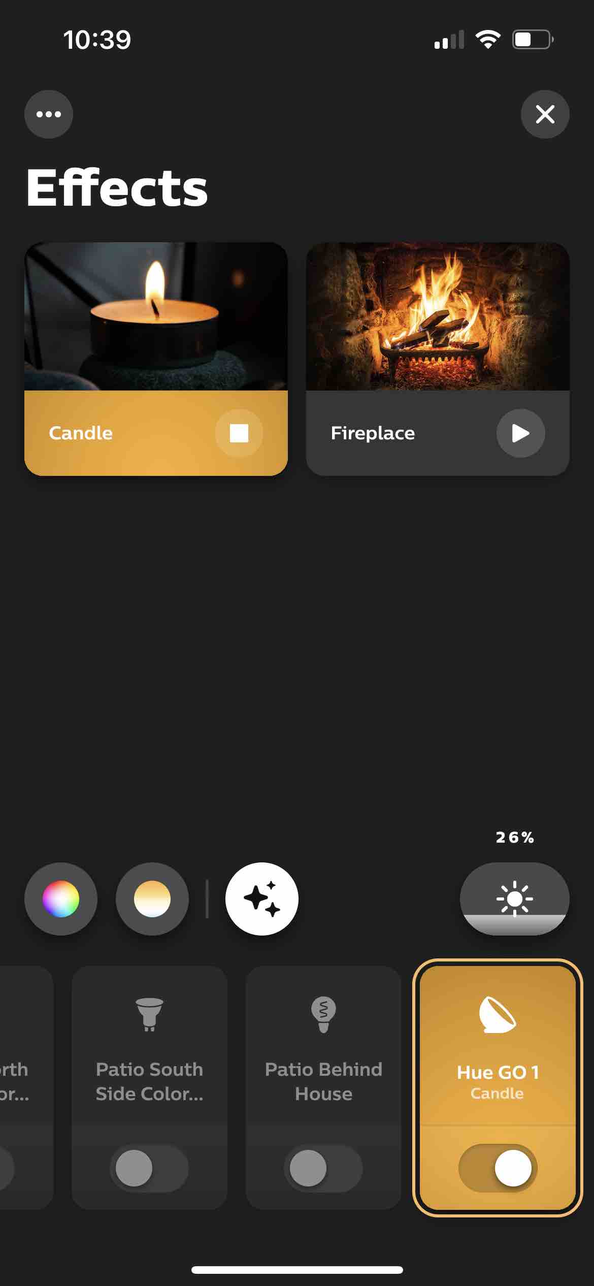

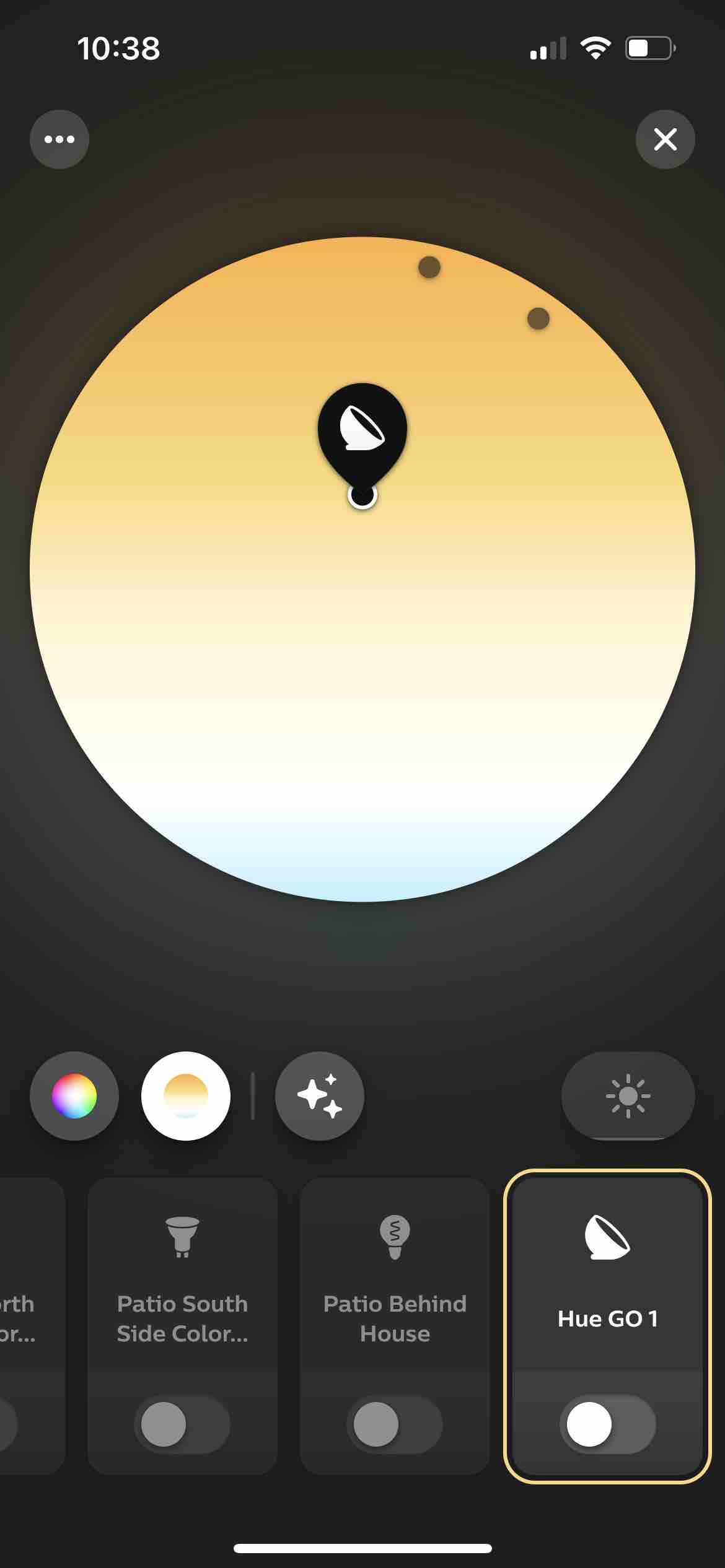

Karl,
Open up Hue app.
Click on group that contains my Hue Go
Click on Hue Go within that group
Click on the 'three star" icon
Click on Candle or Fireplace
Screen shots attached
jroach
Posts: 402
Joined: Fri Oct 29, 2010 6:45 pm
Re: Hue Lights discussion
Post by jroach »
Karl, sorry, images in reverse order.
