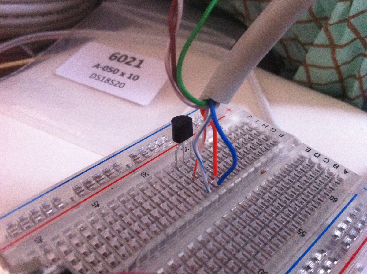

ELWOOD wrote:MrJeffreyGee
My setup has been working fine. I have the LinkUSB connected to 2 iButtonLink T-Sense Temperature Sensor using the RJ45 jacks.
Plus 5 Dallas ds18s20 in a TO-92 package. However I am using the third wire for 5 volt power. The ds18s20 can work with 2 wires (pin 1&2)
as "Parasite Mode" but I think this requires adding a capasitor at the LinkUSB between pin 2 and 4.
Since I am running the sensors on cat5 cable I have the extra wires to pas the 5 volt power to the sensor.
Hook up pins from the LinkUSB to the ds18s20 as the following:
LinkUSB pin 1 and 5 to ds18s20 pin 1 (ground)
LinkUSB pin 2 to ds18s20 pin 3 (+5v power)
LinkUSB pin 4 to ds18s20 pin 2 (1-wire data)
Hope this helps
Elwood
Thank you so much for helping. I tried wiring it up like you described, but still no luck. I also tried changing to a different USB port, but there's no difference. My first USB port was a powered hub and the second one I tried was on the back of the Mac.
DS18S20 LinkUSB Wiring
Photo Feb 21, 3 11 28 PM.jpeg (389.61 KiB) Viewed 9707 times
travisc
Posts: 346
Joined: Tue Sep 07, 2010 7:24 am
Location: Toronto, Canada
Re: DigiTemp - 1 Wire Temperature Plugin
Post by travisc »
It doesn't look like digitemp is outputting anything at all. Try running it directly from the command line:
1. Disable the DigiTemp plugin.
2. Open up a Terminal window.
3. Copy/Paste this line into the terminal and then hit enter:
cd "/Library/Application Support/Perceptive Automation/Indigo 5/Plugins (Disabled)/DigiTemp.indigoPlugin/Contents/Server Plugin/"
4. Lets start real simple. Type the following line into the terminal and hit enter:
./digitemp
You should see this followed by a bunch of help text:
Error! Not enough arguements.
DigiTemp v3.5.0 Copyright 1996-2007 by Brian C. Lane
GNU Public License v2.0 - http://www.digitemp.com
Compiled for DS9097U
5. If that worked lets try a 1-wire walk. Copy the following line into the terminal, replacing PORT with the serial port you selected in Indigo, then hit enter.
For example, in Indigo my DigiTemp serial port shows up as usbserial3. So I would enter ./digitemp -w -s /dev/cu.usbserial3
./digitemp -w -s /dev/cu.PORT
If everything is working correctly, you would see something like this:
Turning off all DS2409 Couplers
Devices on the Main LAN
2888DE5D020000A3 : DS18B20 Temperature Sensor
28481B5E02000044 : DS18B20 Temperature Sensor
285CB45D02000017 : DS18B20 Temperature Sensor
Paste the output here so we can see what's going on.
