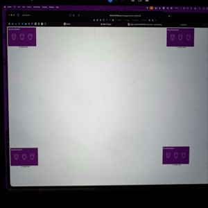

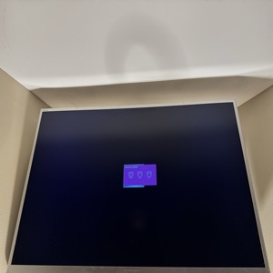

Here’s a screenshot to show the issues I’m having. So I’ve created a brand new control page, with a blank background and set the size as 3840 x 2160 (I’ve also done this with 1920 x 1080 with same results so scaling seems to be working anyway)
On safari the page loads as expected:
On Kiosk Home TV:
The image that is showing is the one from the top left corner. I’ll test it on the 4k tv tomorrow.

Need an image background I would be guessing even if black
If no background image - I will have too add support for (maybe, and likely just a solid colour image ) but currently a image is important to set scale and aspect
