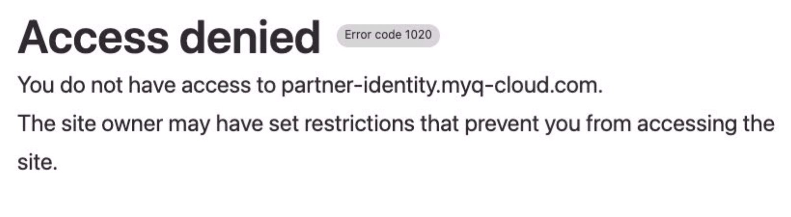

Trying to access from the browser but looks like we are blocked.
Screenshot 2023-10-19 at 8.35.11 PM.png (457.04 KiB) Viewed 3552 times
Posts: 7823
Re: Error logging into MyQ server
Yeah, you can't go directly to the URL. It needs a redirect or parameters from the start of the auth process. I'm seriously doubting this will ever get fixed in a way that works for a plugin.
