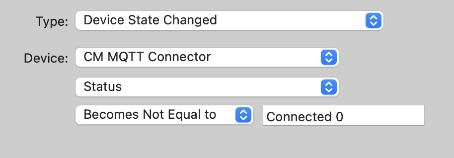

berkinet wrote:...UPDATE: I have added a trigger to catch any MQTT Connector disconnects and restart the plugin and send me a log snippet.
I have not yet tried running the plugin in debug mode. But, I did find an issue with the trigger I wrote to trap the plugin failure. I could not figure out a specific state to trigger on, so I just chose not equal to "Connected 0" (image below). But, that did not catch a failure. Unfortunately, I absent mindedly restarted the plugin before looking to see what status state it was in -- and it may well have still been "Connected 0" Any ideas on how to trap the problem? And, yes, next time it happens I will printout the device before doing a plugin restart.
Screenshot 2023-03-04 at 13.38.15.png (47.83 KiB) Viewed 2811 times

I am still seeing this problem on a regular, like every two days or so, but not on any exact schedule. Do you have any more ideas on how I can collect some useful information on what is causing the failure? The only thing I am seeing in the log is the execution of the trigger that is watching for a Connector failure
MQTT Connector Error            CM MQTT Connector: Disconnected with result code 1
As noted before, running in the interactive shell shows nothing at all.
