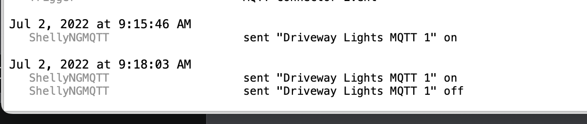

Updating again. I have all my devices active and working. However, some show up in the log with their correct names, whiles other show up as new device. I cannot determine the rhyme or reason to the pattern,

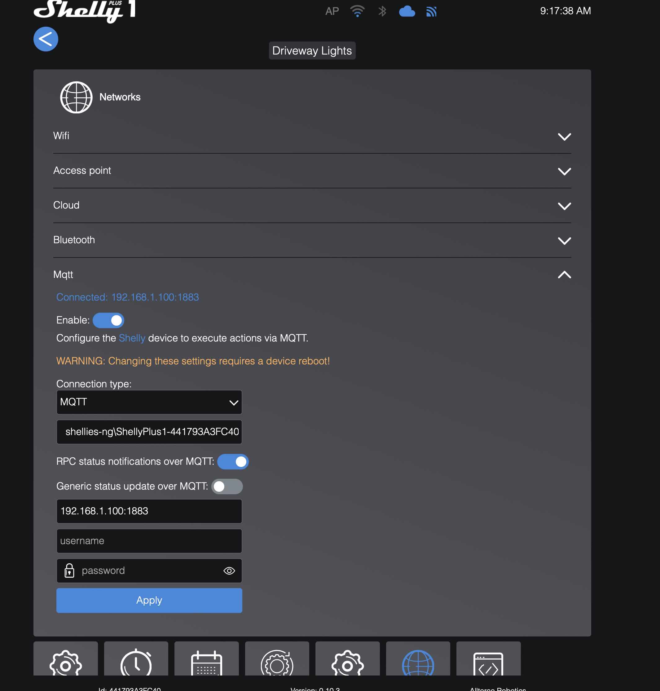

I am sorry to keep posting. I have the names showing properly in Indigo now, but I realized teh devices are not actually going off and on like it says they re. My Shelly App still controls teh devices and the ShellyDirect plugin in Indigo works with a few bugs but turns the lights n and off eventually. But the MQTT is not actually turning power on or off. Not sure why. It is tracking the MQTT devices as on or off, but not actually changing their state.

Sorry to keep posting nut I am trying to get to the bottom of this issue and provide as much information so other can help me diagnose.
I am using MQTT Explorer in conjunction with Indigo and the Shelly app.
When I turn on Shelly Plus One device using the app or the ShellyDirect plugin, MQTT Explorer sees the following:
{"src":"shellyplus1-a8032aba4f74","dst":" shellies-ng/ShellyPlus1-A8032ABA4F74/events","method":"NotifyStatus","params":{"ts":1656774055.79,"switch:0":{"id":0,"output":true,"source":"HTTP"}}}
When I use the ShellyMQTT beta plugin to turn on, I get this on explorer:
{"src": "shellies-ng/ShellyPlus1-A8032ABA4F74", "params": {"on": true, "id": 0}, "id": "66abc716eb0a47a4af6997d9655c837a", "method": "Switch.Set"}
The former turns the lights on. The latter does not.
What am I missing?

Re: Having trouble getting started
Compared the webpages with my device info entered in Indigo. Needed to clean up a leading space and a few other mistypes. All working now!!! Thank you.

I see your message type is: shellies-ng\ ? the "\" is not in Aaron's instructions. Is that a mis-type possibly?
It does not matter if you write shellies or something else as long as you are consistent and have a trigger. Many of us use shellies-ng for ShellyMqtt NG to differentiate from ShellyMqtt.cuhouse wrote:What Shelly app are you referring too?pgershon wrote:Sorry to keep posting nut I am trying to get to the bottom of this issue and provide as much information so other can help me diagnose.

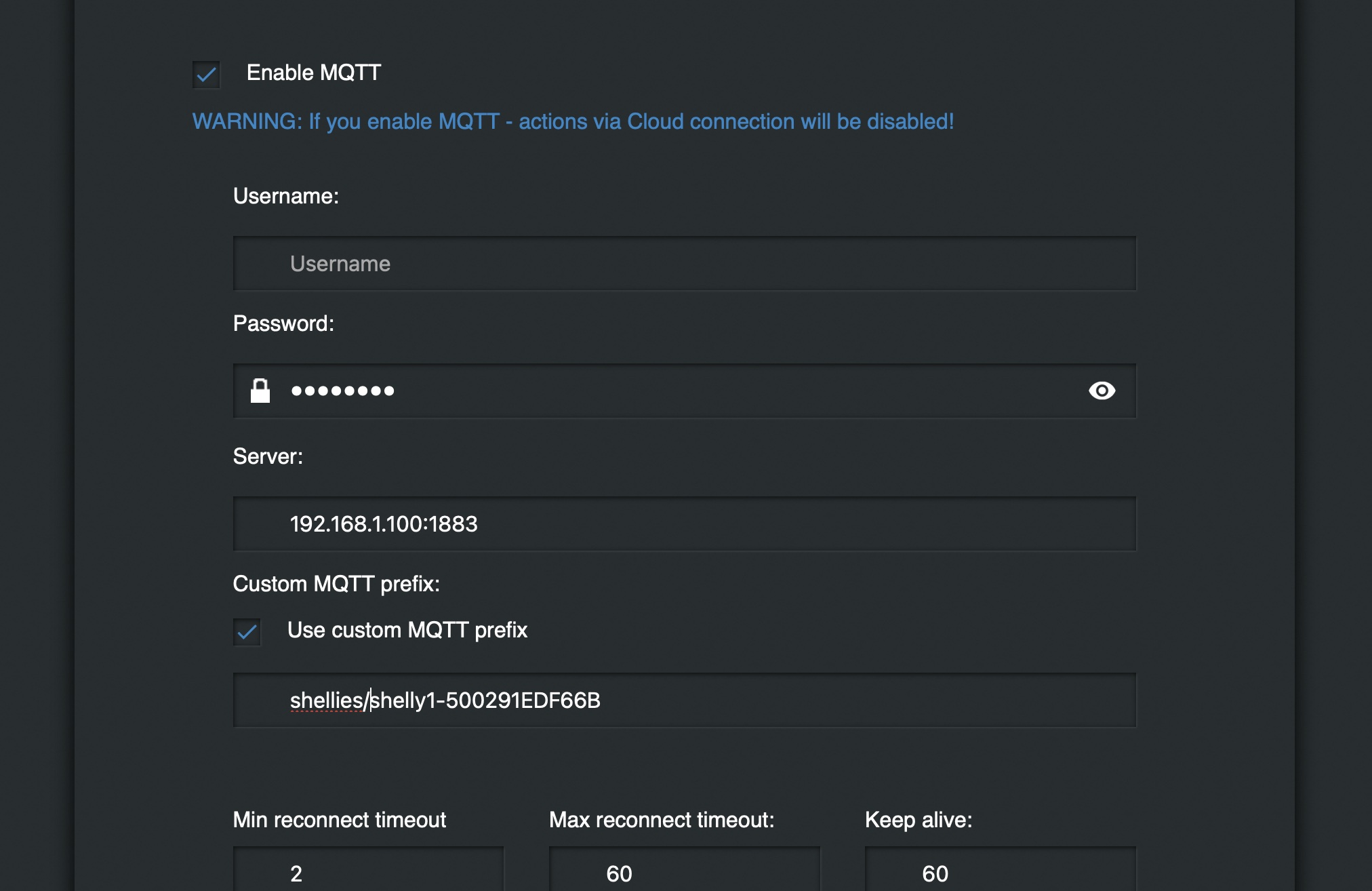

I now have all the Shelly Plus One devices working. I realized I have one Shelly One (old style) too. I cannot get the device to work with the old plugin.
It seems that ignorer to get the old Shelly One to broadcast MQTT, I must turn off cloud connection. This disables my ability too use the Shelly app on my iPhone. I did not have this issue with the Shelly Plus One devices. Is this by design or am I missing something? My steps are below... (and thanks to everyone making suggestions)
I have the ShellyMQTT and ShellyNGNQTT enabled. Same MQTT Broker for both: Two different triggers - one for each type (with or without NG): Set device webpage to enable MQTT

The older shelly devices use the ESP8266 SoC, so they are generally inferior to these new devices (they have an ESP32). They have less memory, onboard storage, processing power, and less efficiency. So yes, it is by design (of Shelly) that you get to use MQTT or Cloud, but not both at the same time. There is also a note in the web UI that confirms this, "WARNING: If you enable MQTT - actions via Cloud connection will be disabled!".pgershon wrote:I now have all the Shelly Plus One devices working. I realized I have one Shelly One (old style) too. I cannot get the device to work with the old plugin.

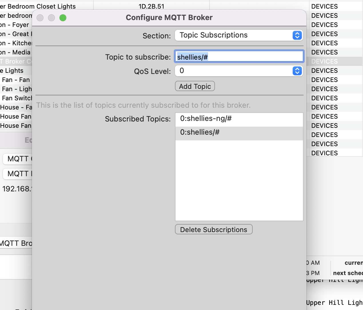

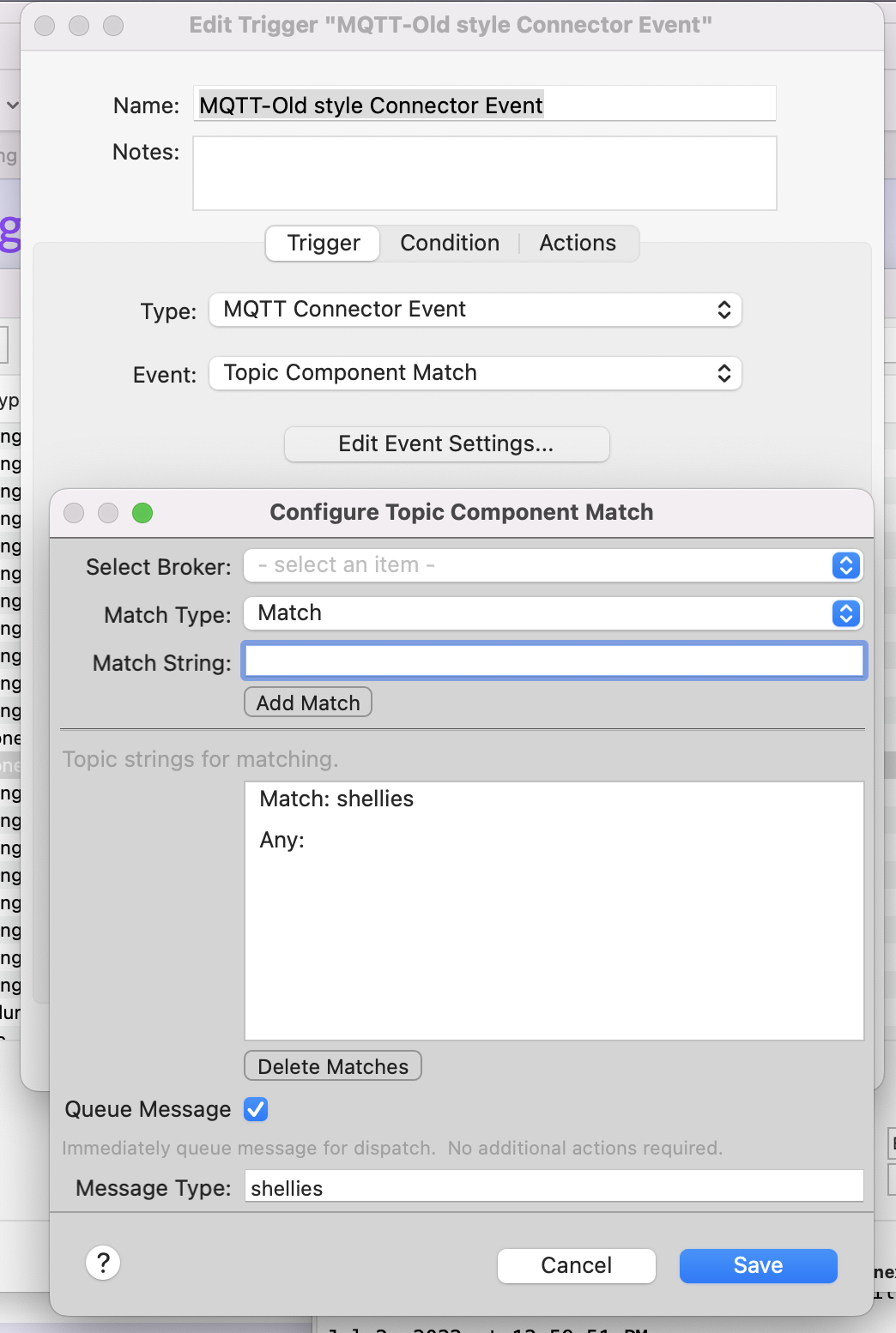

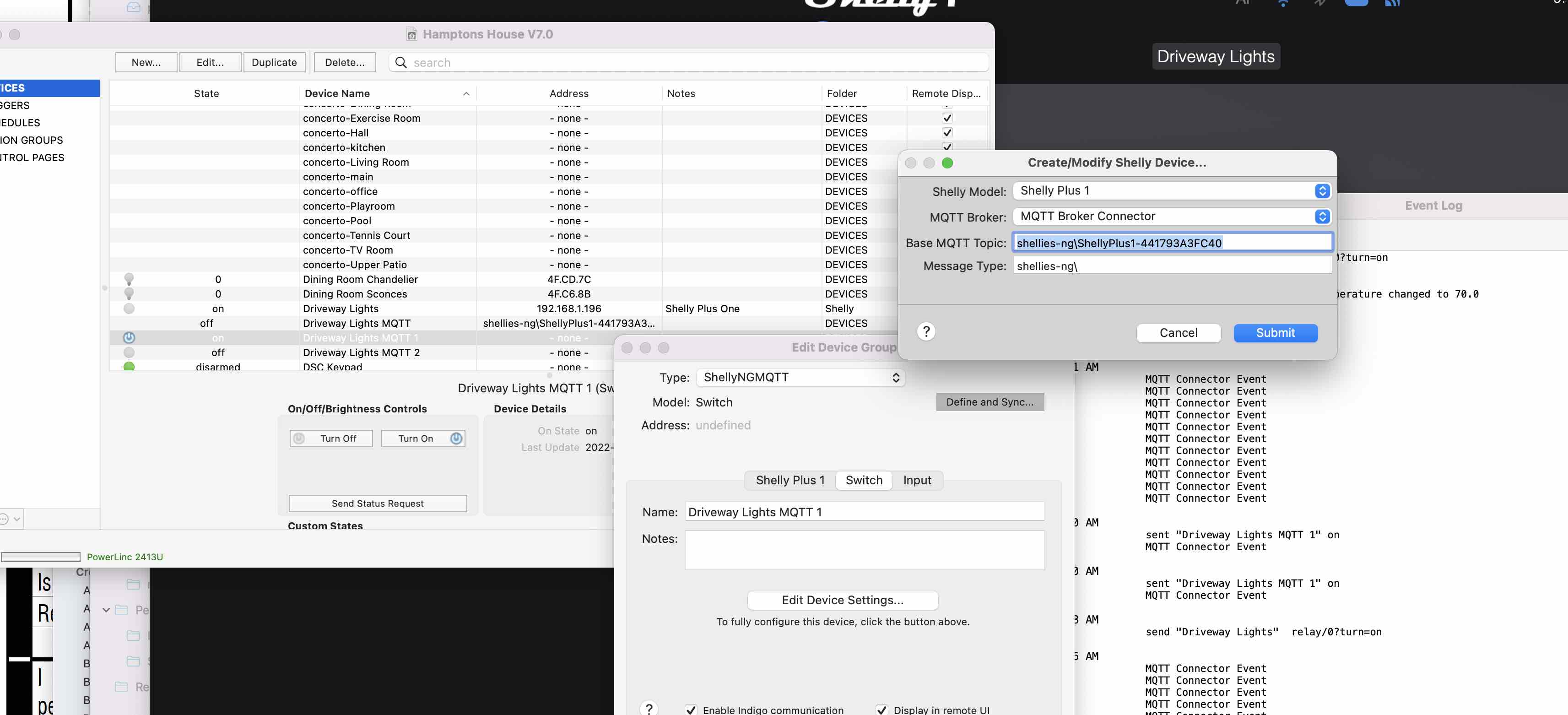

Can you confirm that your Topic Component Match has the broker selected? The screenshot you provided has this empty. Please also show the screenshot of the device configuration in Indigo. I'd like to confirm the address matches what you have specified.

Ah I think I see the problem. Please try unchecking the "Use custom MQTT prefix" in the Web UI. The old devices don't need that set and default to broadcast on shellies/<device_id>. Then, in your Indigo device config, update your address to be "shellies/shelly1-xxxxx" (filling in the x's).pgershon wrote:Thanks. After playing with both of your plugins, I think I will make it my go to method (Karl's plugin does not do the Shelly One Plus well at this point at least).

I don't think there is a way around using MQTT and the Cloud connection at the same time on the old devices. The old generation of devices don't seem to have enough processing power to keep an MQTT connection and Cloud connection established at the same time.

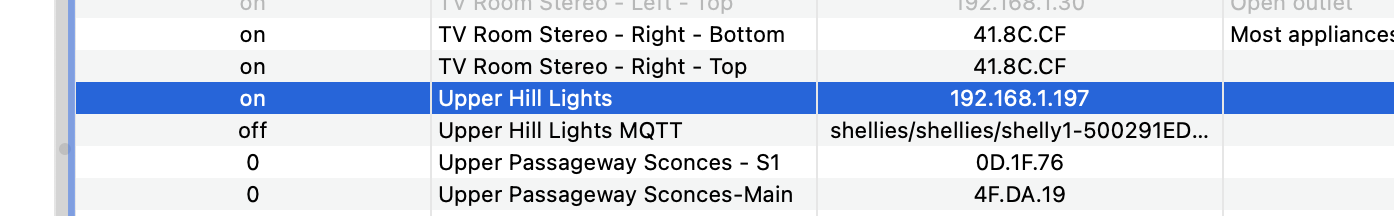

Thanks. I turned off custom and was able to get rid of the extra "shellies/" in device name. It certainly works. One thing I notice is that when I turn device on/off from web page (using its static IP address), MQTT does not see the status change. And the "send status request option" does not correct. the problem.
Looking at MQTT Explorer, there is a MQTT message sent when the light is turned on. And The Shelly Direct plugin is updating status. But the ShellyMQTT is not upating. And the send status request is sending something over MQTT as I can see in MQTT Explorer, but it is saying the lights are off, when in reality the web interface sys they are on.
Of course its possible that the web interface is wrong about the true status of the lights/ Its pouring out now so I cant go out to check.
