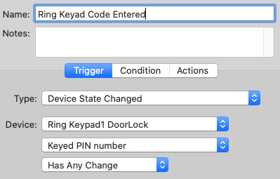

For your plugin to work properly with my keypad, I need to have 2 devices installed. For my setup, that's Ring Keypad Manager (A keypad device) and Ring Keypad2 DoorLock (a door lock device).
Example, if I disable the communication of the doorlock device, the keypad trigger doesn't fire.
I was tweaking your plugin and I added this to line 689
				self.updateState(int(bytes[5]16), "keyedPin", codeVal
after adding a custom state "keyedPIN" to devices.xml. The custom state was created, but I was getting an error that the state wasn't defined. Then I started to realize that it was looking at the Ring Keypad2 Door Lock. So, I added a device state to the lock devices in the devices.xml, and now when I enter a PIN, it populates the state of my keypad lock with the entered PIN number.
So I have it working... but I have to use two devices (three if you count the actual z-wave device) to make it happen. From there, I have a trigger that watches that state for changes and runs a script to check the PIN number against the PIN numbers of the people in My People plugin.
Screen Shot 2021-01-24 at 9.55.22 PM.png (25.04 KiB) Viewed 5349 times
