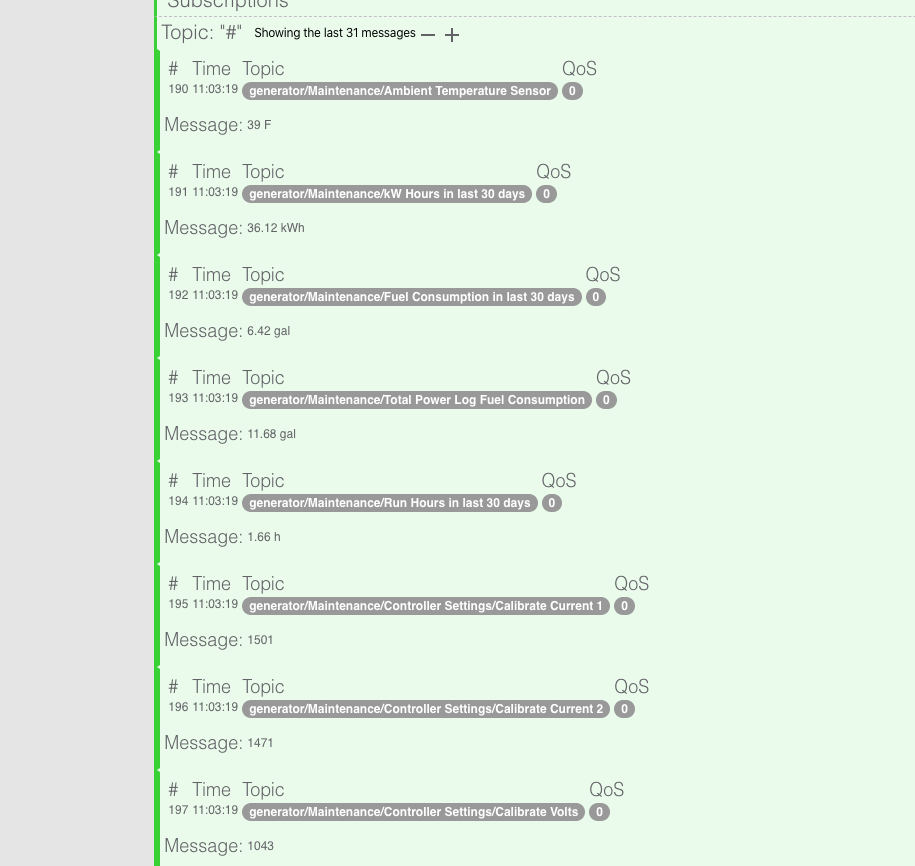

What kind of Generator/Interface is this? Is the MQTT API documented anywhere?
- Posts: 7830
Re: Shims SetUp
Oh, if you can have it send actual JSON instead of Raw, you might be able to get this to work. Please just post the output from the MQTT monitoring tool first. Skip all the other screenshots.farberm wrote:JSON - typo
Re: Shims SetUp
On the MQTT device (the generator) I have the option to return numeric values in the Status topic as a JSON string which can be converted to an object with integer or float values.
When that is turned on some topics have value included but not the Ambient Temperature Sensor, but I get values for Voltage....
When I turn this option off I get no values for any topics just what you see below.
- Screen Shot 2020-02-16 at 11.04.00 AM.png (116.5 KiB) Viewed 2505 times

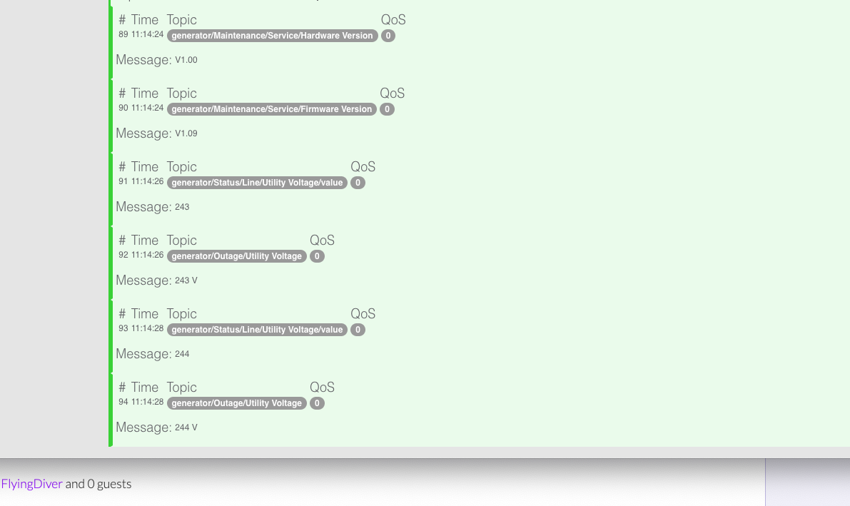

Post the output with the option on.
Re: Shims SetUp
Here is is with it on. Some of the topics have value... Specifically Utility Voltage/value
- Screen Shot 2020-02-16 at 11.14.35 AM.png (98.21 KiB) Viewed 2517 times
Re: Shims SetUp
Also if I add "Match: value" to the topic component in the temperature trigger then I never see an event in the event log suggesting that the trigger never occurs... therefore no value for that topic. If I stop sending JSON as value then the other triggers never occur also suggestion that it stops sending values. I guess it is only sending values for certain topics?

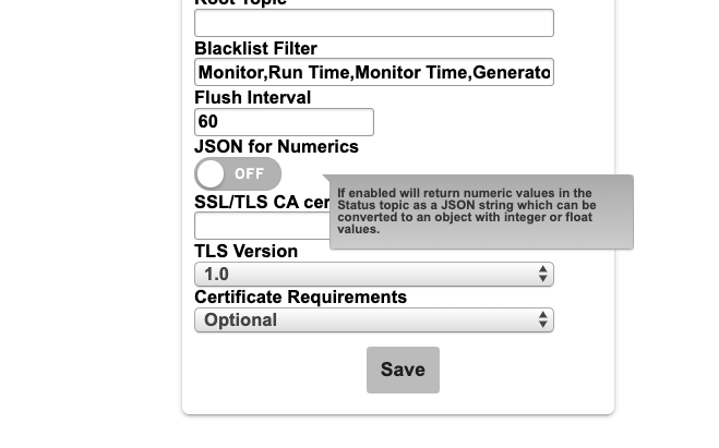

here is the screenshot. I can ask the programmer to see if they can be included. The device is a Generac Generator
- Screen Shot 2020-02-16 at 11.04.40 AM.png (46.85 KiB) Viewed 2510 times

Third and last time: What device is this? Manufacturer? Model? Website?

Sounds like to get actual JSON you need to do the command "generator: status_num_json" thing. That option is misleading because that just changes the value fields in the JSON output from string to numbers, but doesn't actually turn on JSON output.
