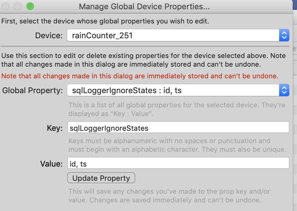

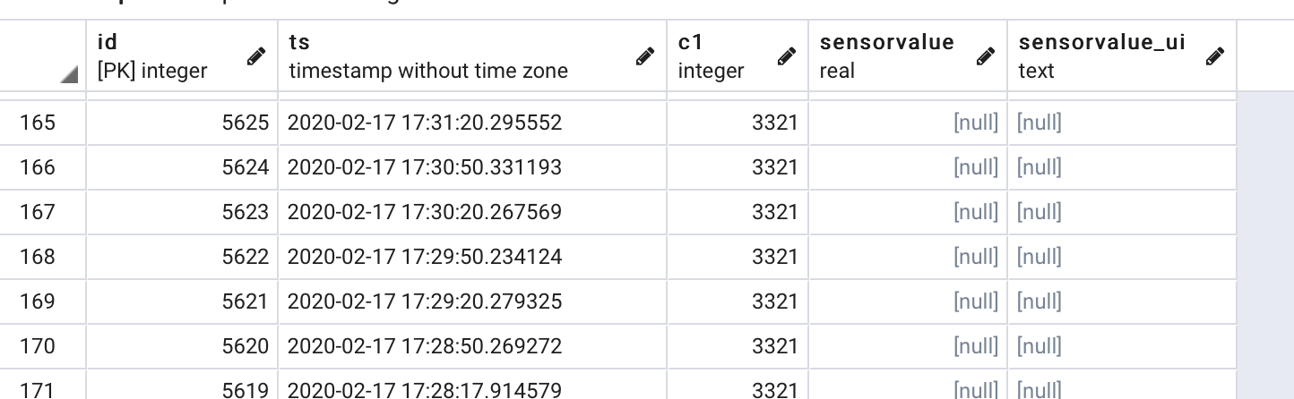

I created global properties for two devices (MQTT connector and a shims device). The MQTT connector device I did 'sqlLoggerIgnoreStates: *' which blocks all incoming sql-logger, and for the Shims Device - 'sqlLoggerIgnoreStates: id, ts'', but it still updates the table even though there are no changes (except the suppressed ones). See the picture. Have I created the global properties wrong?

Looks like you need to add c1 to that list. Whatever it is.

Do add c1. You might actually not need id and ts. Those are probably not really device states. Won't hurt to leave them though.

I guess I don't fully follow how this works...:) I'll try it.

I’ve used it for a few days and it works great. Thanks!
